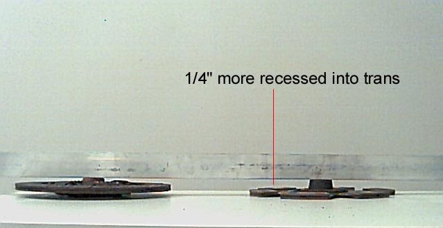

I took some rough measurements last night from my collection of parts that I am using to plan out my V8 swap, here is what I have found.(sorry if you've heard this info already from me directly or seen it in the homebuilt V8 thread-some measurements are not exact)
The Fiero flywheel sits 13/16" off the face of the 2.8 block.
The face of a the flywheel on a 350 is 1 3/4" from the block
The springs that appear to have rubbed on the HTD kit are roughly(very roughly) 0.3" from the back face of the clutch disc(this disc was used as well so the dimension might be less on a new disc)
I do not have the dimension, I'll call it X, from the face of the block to the face of the crank snout on a 350. (the motor I am using is on a stand currently with a flexplate still attached-I will remedy that this weekend)
To maintain stock clutch operation using a 350 flywheel you need to use an adapter plate about 1" thick using the above measurements. 1.75"-13/16"= roughly 1"
To use a 1/2" adapterplate and maintain the same clutch operation then obviously something has to give up that 1/2". Its my understanding that it is the flywheel that does this.
This means that the maximum thickness you can have in the center of the flywheel where it bolts to the crank is
=1.75"-X-3/8"
(the 3/8" is the clearance for above mentioned springs in the clutch disc)
If someone out there has a 350 with a crank insalled and they can measure the distance from the block face to the surface of the crank that the flywheel bolts to, diatance X,(on a 2 pc crank seal, pre 87) then we will have a rough figure for the maximum thickness the flywheel can be, INCLUDING BOLT HEADS, on a kit using a 1/2" adapter plate. Of course this is leaving VERY little room for a worn out disc, flywheel machining or larger diameter springs in the clutch disk. If this figure suddenly comes out to be anything less than 1/4" then yes I would start be quite concerned about the strength of the flywheel.
Again these measurements are not perfect and some(all) of the parts involved are used. I'm leaning towards making my adapterplate 3/4" thick if I make a custom flywheel or sticking with 1" if I use the stock 350 flywheel I have recently purchased.
I suspect for this reason if one was to make a custom flywheel then a one pc rear seal crank on a SBC would probably lend itself much more favourably to this type of setup with a thinner adapterplate.
Did anyone follow me there? Its hard to explain without being able to frantically wave my hands all over-hehe

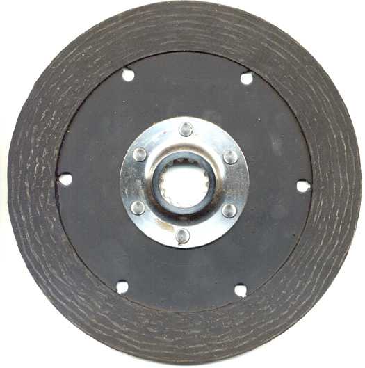

I wish I could give you all the specific details, but being the "second hand" owner doesn't allow me to get down to the exact changes. The person that can technically answer exactly what was changed is Keith Huff (think you can reach him through WCF, but don't know if he'd be willing to take the time to get into detail with anyone). Only very minor structural metal changes were made in this conversion, a dime size removeall of metal on the right shock tower for TPS sensor clearance and a very small area at the left frame rail (which was boxed in with additonal metal welded in for strength) for clearance to the trans tailstock of the 5spd Getrag.
The most sigificant changes were to the flywheel which has an insert plate (tool steel) at the clutch disk bearing surface. It was also machined to accept the QuarterMaster double disk clutch setup.
I do have a 4 page article from "Fiero Owner" 2nd Quarter '95 titled V8 Build that was written by Keith Huff about my car. It doesn't get into exact hard specifics and doesn't cover the QuarterMaster setup, which was done after the article was written (you'd also have to be willing to shell out about $1,000 to go with this clutch setup, which I would recommend for hp/torque over 330). I can e-mail this article to you, but each page is about 2MB and don't know what size mail box you have (can't post here on Pennock's because you would be able to read them in the size permitted for posting).
I've never had a reason to disect and dimensionally check this conversion, the most significant change that I've made to the clutch setup was to replace the flywheel insert plate (that was warped due to severe heat abuse during clutch testing phase), and machining off 0.020" from the flywheel mateing surface of the QuarterMaster housing ring (to reduce "free air" stack in the clutch pak for longer disk life). The race clutch disk's are only good for about 10 to 20k miles depending on how you drive the car (my case, pretty hard and I'm over 10k on the current set and still no slip in sight).
It will take some time, but do a search on California Kid in General Topic and Tech. I've posted nearly all I know about my car on this Forum.
Sorry to say that Keith Huff is the only one I know that can tell you exact details. Also know that Keith would not encourage anyone to run the hp/torque that I am, it's flirtin' on the edge to all parts concerned.

Thats exactly what my next question was going to be 'Kid. Something must have been done to gain clearance in that area. What effect does removing the springs in the clutch disc have?

From what I can see it allows the clutch disc to get closer to the flywheel, ie no spring humb stamping or springs taking up space.
Really has no effect except that with this system you aren't suppose to slip the clutch (really bad news for race clutches anyway, the compound is different and thin so it doesn't hold heat). You just let the clutch out a little faster than you normally would, hardly any rpm required for a V8 anyway. It's just a little racing way to get going, you have to be careful if you're drinking coffee (hehe). Most people I take for a drive don't even comment about the starts from stop, it's pretty suttle.

Thats very interesting 'Kid. I would not have thought one could remove the springs without a more adverse affect on streetablity. Not that I was about to go and design my own clutch but its good to know none the less.

Tom? would you say that with this clutch, it'd be a streatch for the car to be your daily-driver?
(though certinly it could be your good-weather driver, if you lived not too far from work in a country/few-stop-signs area. That's pretty much what my stock Fiero is right now actually.)
The lack of any springs in the clutch pack means that the Zumalt kit's flywheel has no more clearance issues with them... as they're gone...
Something like a Koush-loc springless clutch could also maybe work?
But the gist of this is that unless you like doing the other 25% of engineering left to get the swap runnable, have or have access-to, a good machine shop and parts designers.... well, you get the idea.
Best! Ben.

Ram's kevlar clutch for the Fiero is also void of dampening springs here is the standard clutch disk and it side by side. The stock one is flywheel side up the Ram one is flywheel side down. But the ram one will hit the sleeve the throughout bearing rides on if un modified in a getrag

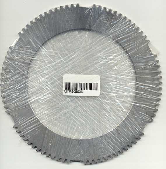

Originally posted by artherd: Tom? would you say that with this clutch, it'd be a streatch for the car to be your daily-driver? Best! Ben.
If you get the 3 disk setup to package on the trans splined shaft, it would be one hell of a daily driver with a lot of clutch life.
For those of you who Ben and I haven't talked to about the QuarterMaster setup, there is an issue with packaging the 3 disk versus the 2 disk setup. Ben is working with QuarterMaster trying to get it to package on his Getrag/Northstar conversion. This could lead to a "break through" for the high horsepower guys with disk changes not required until about 30k to 40k miles, because it's a 1/3rd increase in surface area.

The 2 disk setup works fantastic, don't get me wrong, it doesn't lack anything except long term wear. I only put 5-6k miles on my car a year (summer fun, hard driving), so getting 3 years life out of the 2 disk setup doesn't bother me. The 3 disk would not benefit me except to increase the mileage before replacement.
For someone starting a fresh conversion the 3 disk setup would be the way to go, you'll get more mileage of the disks, and you could significantly pump the hp/torque over my setup (caution here, because you're going to find the next weakest link which will probably be the trans or CV's). Frankly, I'd like to see someone build a monster just to see what happens (hehe).
While I really like my car, if I were to start from scratch, I'd consider trying to package a Grand National Turbo type engine in the fore/aft direction through a 4spd auto (never have been real keen on the transverse setup). I think there is enough room without frame stretching and cutting into the trunk area. Just a dream, but I think it could be a great package, if you could adapt a trans for it.
There's enough splined legenth on our input shafts (that's not dirty It's just a matter of positioning the clutch body itself wrt the power take-off of our engines. Tricky. (if you went to a 1" adapter plate<from teh 1/2", it'd probally clear
I'm looking for ~25-30kmiles, if I get anymore, I'll jump for happy happy joy!
More surface area == more material to heat == clutch dosen't get quite as hot quite as fast either (I hope!
