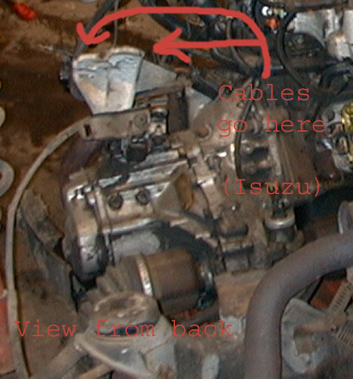

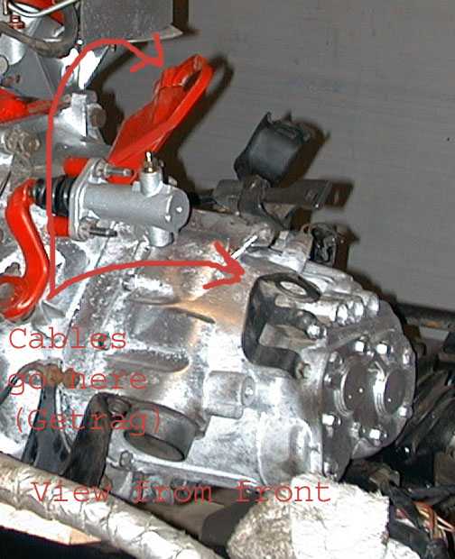

Report this Post03-26-2002 04:02 AM Click Here to See the Profile for wattsSend a Private Message to wattsDirect Link to This Post
Originally posted by ITB 2M4:
Also, I have an '85 SE parts car with a 5spd. in it. Any idea which one it would be?
You mean how do you identify which is which?
Two easy ways.
1) Getrag's have a dipstick (two styles)
2) Getrag's have the shift and select cables at about 90 degree angles from each other, the Isuzu's are right beside each other.
As they say... picture says a thousand words, so...
Clearer now?

watts:
I cannot thank you enough for posting those pics. I have never seen the two side by side. From looking at my old pics my 87 GT had the Getrag 5 speed. Again, I refer you to my signature
I shall be kicking myself for selling my 87 GT until I replace it.
