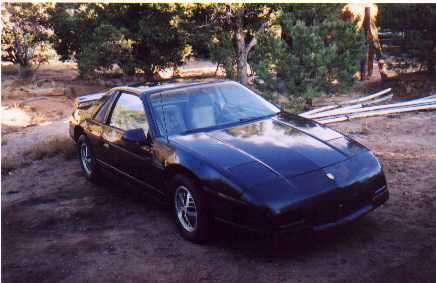

I've got 235/60 R14's on my stock 14" Hi-Tech rims (85 GT) w/ no problems so far.
The Black Beauty (85 GT) - Bustedato (86 SE, Parts car)
Don't sweat the petty things, and don't pet the sweaty things
