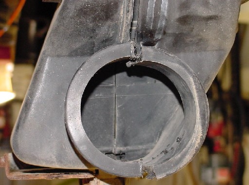

Many times in the tech forum I've read people advising to "knock out the inlet restrictor because all the air that gets to the engine goes through a hole the size of a screwdriver blade". I always found this a little hard to believe but, while working on the Finale, I had my airbox off and I'm never going to use it again so I decided to take a look at it.
If you look in the inlet, behind the little plastic screen on the side of the car, this is what you'll see.
Sure enough, at the bottom is the little slot. That must really restrict things. How can that provide all the air? It doesn't.
When you cut it open and see what's inside, it's clear how it works. This is what you'll see.
I drew the arrow to show the airflow. The air comes in and makes a 180 turn over the dam. As it does, the water is thrown outward (up) since it can't make the corner as fast as the air can. It hits the top of the water separator and runs either back out the inlet or on the back side of the dam and then out the little screwdriver sized hole.
The air never has to go through that little slot. What this means is that knocking the dam out will do little, if anything, for your airflow. Particularly with a stock engine. What it WILL do is increase the inlet noise since the turn also acts as a small muffler for it. The 6.2L diesels have a device on their intake that is strictly for muffling and works much the same way.
Morals to the story. Just because it's repeated over and over on the internet doesn't make it so and if something just doesn't seem right, it probably isn't.

I never said this was the best intake available. I use a ram tube myself in our car. My point was that it's commonly said here that the air going through this inlet all goes through that little screwdriver sized slot. That's not correct, in fact virtually none of it does.
You're right, ideally a nice, straight shot would be better. But how much better? If there's enough intake volume, the difference in removing the dam will be negligible, and I think many here have found out that fact for themselves.
I wouldn't try to let a 3800SC breathe through this, there won't be enough volume. A 4 cylinder? It might as well be not be there because that's all the restriction it will see. A 2.8 might gain a pony or two, but honestly I doubt it.

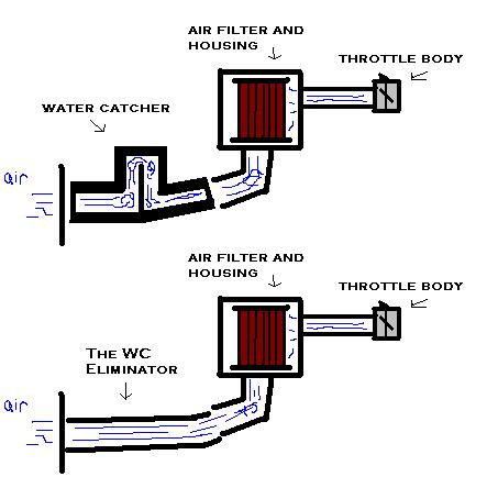

whome ever said it gets sucked in by the screw driver sized slot is a dumbass. I didnt even cut mine in half you your can easily figure out how it flows, hence, i made this shortly after i took it out:

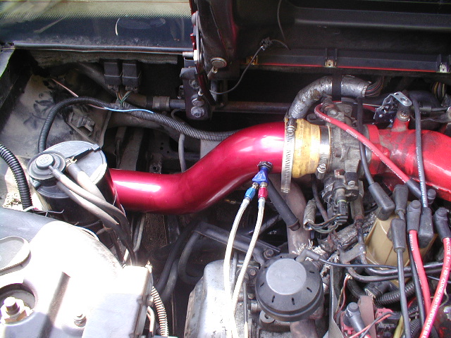

my setup:
My quarter mi. speeds are higher with the open element and no water separator. However, I seem to have quicker 60ft with the stock setup and a drop in K&N. Guess it proves either 1)Gain HP, lose TQ, or 2) I'm an inconsistent driver, in either case, it makes a nice noise.
