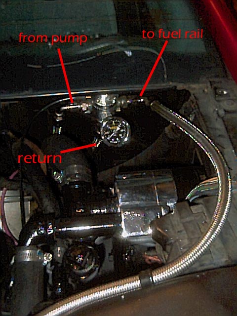

Here is a pic of my fuel regulator set up. With out the gauge it would probably fit behind the battery. Summit has one (pn: hly-12-803) for 21.95 that would do the trick for you. If you wanted to go something like mine Mallory has one for $74.95also through summit
LS1 in and running :)

Thanks for the help everyone. If I read correctly, the thread above says that the return line is not neccessary with the 4 cyl fuel pump. I am unsure of the exact workings of the pump's internals, but I'll buy it. However, I like LS1's setup. Its clean, neat, professional and most of all... Done right the first time. I am going to run the regulator setup as shown. I like it...Alot.
Thanks...
