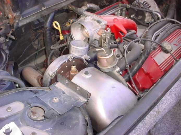

Report this Post10-30-2002 02:11 PM Click Here to See the Profile for Her86GTClick Here to visit Her86GT's HomePageSend a Private Message to Her86GTDirect Link to This Post
Originally posted by cadero2dmax:
a stage 1 turbo could put about 8lbs boost on this motor
You mean something like this?
1FST2M6

Report this Post10-30-2002 03:04 PM Click Here to See the Profile for 1FST2M6Click Here to visit 1FST2M6's HomePageSend a Private Message to 1FST2M6Direct Link to This Post
LMAO!! you've lost your mind!! let me know when your done!! and PLEASE post a dyno sheet!! OMG!

Report this Post10-30-2002 03:16 PM Click Here to See the Profile for JncomuttSend a Private Message to JncomuttDirect Link to This Post
Wow... turbo 4.9.. Guess this is going to be like juicing the duke. Good luck, if it works, I want one too!!

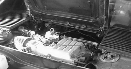

Report this Post10-30-2002 03:40 PM Click Here to See the Profile for RCRSend a Private Message to RCRDirect Link to This Post
Ah, a pic
Now the intakes, they appear to be wet-style or carburated intakes with bosses machined for injectors. True or false? Is the intake a single plane or dual plane design?
Turbo 4.9...Cool

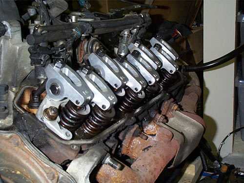

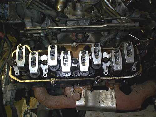

Report this Post10-30-2002 06:59 PM Click Here to See the Profile for rockcrawlClick Here to visit rockcrawl's HomePageSend a Private Message to rockcrawlDirect Link to This Post
Here are some pics of a set of full roller rockers on a 4.9. They are Angus Racing 1.6 ratio pedastal mount (FORD) rockers with adjustable pushrod seats. The adjustable seats eliminate the need for custom length pushrods and shims under the pedastals. I machined slots in the stock rocker support rails to eliminate the need for bridges or pushrod guides. The pedastals have two flat sides to fit in the slot. I installed threaded steel inserts to prevent the pivot bolts from pulling out of the aluminum rails with higher lift and spring pressures. I've seen them pull out on stock engines. The stock valve covers don't fit, they will need to be custom made. Unless you can find a used set, these rockers will cost you about $280 for a set of 16, I got mine for $125. I doubt it's worth the money and effort, but it should add about 20 hp.
WOW, nice job!!Get that working and it will be a screamer. Only difficult problem as I see it will be developing a new program for the chip in the Caddy ECM. I believe that you must use the original ECM as only the Cadillac ECM has the capability to control the special idle speed motor that the 4.9L used.
Where does the extra power come from?
I thought that the stock 4.9 rockers were 1.6:1. You don't expect to get that much power from going to a roller rocker, do you?

Report this Post10-31-2002 04:17 PM Click Here to See the Profile for rockcrawlClick Here to visit rockcrawl's HomePageSend a Private Message to rockcrawlDirect Link to This Post
You are correct, 1.6:1 is the stock ratio. I don't think 20hp gain just from the rockers is an unreasonable expectation, especially considering that the the stock ones are not a high performance design to begin with. I've always been under the impression that changing to full rollers alone will add 15 to 20 hp to a V8. Since you questioned it, and now I'm questioning it, I've done a little reading. It looks as if the reduction in friction is enough to make a noticeable increase in horsepower, regardless of ratio. I'm sure those 40 hp gains are when using higher ratios.
from unknown source... "Aluminum roller rocker arms provide several virtues to the operation of any valve train. Their needle bearing trunnions require very little oil compared to the requirements of conventional "ball" pivot or bronze bearing designs. Accordingly, they have a much reduced "drag coefficient" which reduces the loss of horsepower due to friction."
from Crane Cams... "Needle bearing fulcrum and roller tip reduces friction, lowers engine oil temperature, improves response, increases HP and RPM."
from Harland Sharp... "The unique Friction Free Design has shown average performance gains of 15 to 40 horsepower."
from Comp Cams... "Investment castings, featuring superior ratio accuracy and chrome-moly roller tips. 20 to 30 horsepower gains were not uncommon with this new rocker arm design."
from unknown source... "The needle bearings in the fulcrum also help some in saving wasted mechanical power and some manufacturers claim it lowers oil temperatures as well. It also keeps your valve system more dimensionally consistent in it's operation from valve to valve allowing the engine to operate more like it was designed to. Add that to the fact that the rollers and fulcrum bearings don't rob as much power as standard rockers and it could add up to a significant number of horsepower gains."
No one likes a tease.... Give us some details!!
Specifically What size turbo is that (please don't say T3!!) Also what sort of boost will you be running?
Intercooler? anything done to retard spark on detonation?

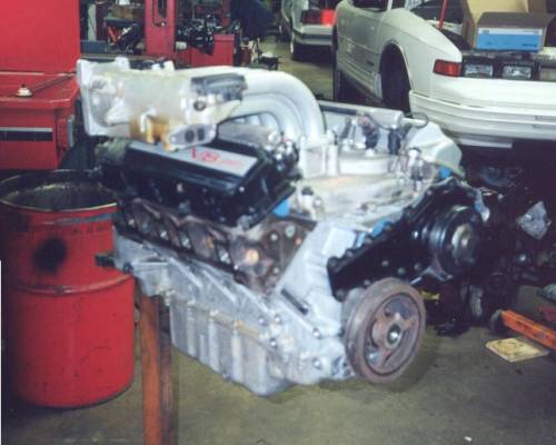

With that custom intake that Rockcrawl made for Her86GT, that should be a 350hp motor (accroding to the desktop dyno run we made at 8lbs boost). The intake that is shown here should have added several ponies in itself, just as the Allante does.
Below is a 4.9 with a stock Cadillac 4.5 Allante intake, on the engine of the 4.9-in-a-Fiero originators (Team Python). That, too increases the performance by about 20hp without affecting torque.

The turbo is from... no it is not a T3. I will tell you all about it in the spring. And you can see it for yourselves at Carlisle PA.
Pete

Report this Post10-31-2002 09:26 PM Click Here to See the Profile for PhilphineSend a Private Message to PhilphineDirect Link to This Post
a turbo trans am? about the same size engine. maybe a grand national?

Report this Post10-31-2002 09:27 PM Click Here to See the Profile for cadero2dmaxSend a Private Message to cadero2dmaxDirect Link to This Post
Wrong!!
The ECM from a GM 305 will also work on this engine - - I know, I have that setup on my car.
G

Originally posted by RCR:
I must be beating a dead horse here.... I've done a little more research and turned up some pics from The Alternate V8 page.
These two pics show what I believe to be the two different intakes (PFI and TBI). Both are essentially the same and don't show much room for porting, without doing a lot of welding. It's hard to give up 100ci by going to a "more" popular swap, but I guess you get what you get...Still would like to see more tech mods, though...
Any idea why GM is using cast iron heads on an aluminum block? Beancounter strategy?

Nope - - not an expert. But I have made that statement many times, including in my original post to this thread.
I am not an engineer. The only way I got the heads flow benched was because the owner of the shop owed me a favor or two. He took a pair of heads - from an "extra" engine I had lying around - and he tried various tricks that normally opens up most motors.
The shop did different things to each single cylinder (except one which was left stock, for comparison purposes). Like I said earlier, the best they were able to do was to extract a little hp, but lost a lot of torque.
Then, in the make believe world of one of the best desktop dyno setups available, all kinds of things were done to extract power.
Without nitrous (I am not sure how the floating sleeves would hold up under a very big shot)we got almost 400hp with about 450lbft at 6000 RPM. But to do that, the engine was modified a BUNCH (punched to 5.0, supercharged, etc). That engine is probably a ten grand motor, in addition.
Now answer me this, how much could you get for 10 grand from a SBC? I'll help you. My son has a 377ci SBC in one of his Camaros. He built it up from an 400ci SBC out of an old GMC 3/4 ton, and he did it for an out-of-pocket of about 6 grand total. This motor now has a little more than 600hp & 450 lbft of torque at the shaft (dyno'd), and is a very streetable engine, even if it is normally aspirated
For an additional $4K, he could throw a wilder breathing set of heads, supercharge, and work that same motor some more - - and get close to a thousand hp and a thousand lbft (and a not very streetable motor).
If I were wanting power, which would I want for my same investment? 400hp or a thousand hp??? Hmmm. let me think - - - -
I will repeat my thoughts about this 4.9 engine. If mid 13's (with mileage in the mid 20's), smooth power, and a light to light performance that impresses all but the big bucks street racer - all for a minimal investment - will satisfy your needs, go with the 4.9. If you want more, go with a SBC.
Yes, there are things that can be done to this engine. If I had Rockcrawl's knowledge and skills, I might persue them. But for me (as well as the "average" Cadero owner, I would like to think) the costs would outweigh the gains. In other words, what it cost for me to get 300/300 from this engine would buy AND install a good Archie's SBC with far better numbers and performance.
