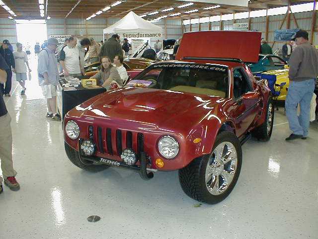

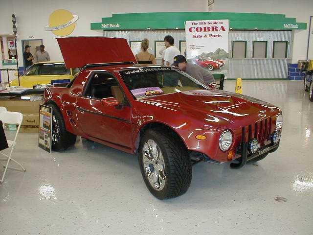

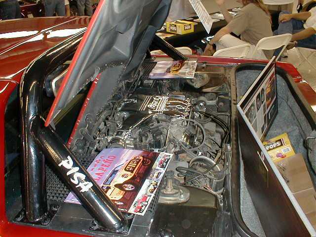

Welcome. I will let the engine questions to the great motorheads we have here. There is a off road Fiero kit that is available. Here are some pics of it. Here are some pics I took of the car a few years ago at Carlisle PA and a link to their site. http://www.cybercars.com/mnfr/fierohq/jalapeno.html

Great forum! been very helpfull. The roll bar and bumpers are nice in the picture, Curious how they done the suspension. I would like to also use a bar across the strut towers thats missing in picture. One other question what is the 1 gear ratio and final ratio on a 86 2.5 5speed.Thanks all.
