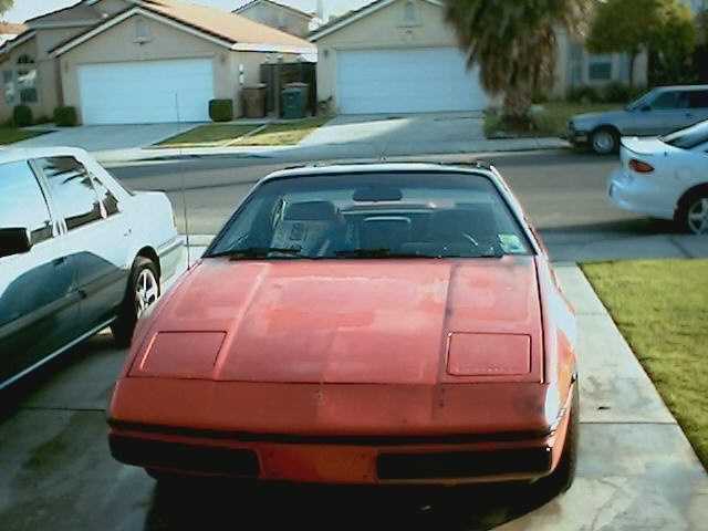

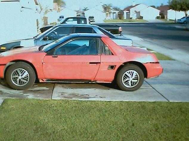

I actually had Earl Sheibe do the work. They were running a special until tomorrow for up to 50% off. My package actually worked out to be about 40% off. I did some of the prep work myself and had them finish it for an extra $80 as I wasn't sure I would have the time to finish sanding before the sale was up. I also removed all the trim I could including the passenger mirror. One think that I would definately have to stress as I wasn't aware of all the damage I had is to really make sure you don't have any spider cracks in the body. I noticed after they painted it that several showed up on the doors as well as the front fascia. It's not noticable from 5-10 feet away but you can really tell when you get close and look at the right angle. I dropped the car off on the 13th around 1 or so and was able to pick it up on the 15th at around the same time. I may move the car out of the garage tomorrow to get some pics to post of it if the weather isn't too bad. They've been calling for rain lately so not sure what tomorrow will bring. In the meantime I'll go ahead and post a couple before pics.
