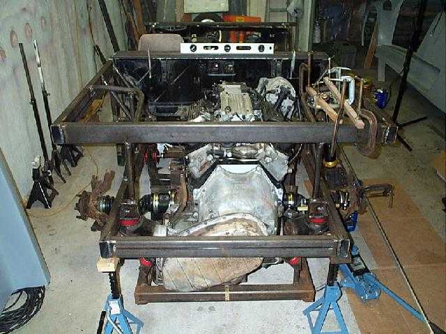

I really didn't give efficency a consideration when I chose to build a Lambo with a THM325 & LT1. There were three driving reasons:
1. The swap is fairly inexpensive and is openended when choosing an engine.
2. The trans & drive train (axles, bearings, etc) are nice & big & able to take the shock of a little hotrodding. I'd hate to build the same car and then go out one night and leave the innards of a 125 trans all over some intersection.
3. My wife (whom I'm building the car for) wanted an automatic trans. Once again, this is a well proven trans for the sedate daily driver, and as such it should yield years of trouble free service.
BTW, that big chain drive = reliability to me.

The axels I'm using are stock Caddy axles that went with the 325 trans. Turns out they are just the right length, so no fabricating is needed, so far. These axles have a bigger diameter & bigger spline pattern than stock Fiero, so I'm using Cieria Knuckle & bearing. Knuckle looks just like the Fiero knuckle, just has a biggger bore for the bigger bearing. Everything lines up fine so far.
I'm building using the Joe Wynman CD "Guidelines" and his aproach to bumpsteer is to fabricate something very similar to what RCC sells. There is a thread currently discussing the merits of this method. I'm able to at least equal the stock bumpsteer using Joe's setup, if not actually eliminate some of it. Won't know till I hit the alignment shop, cause my bumpsteer measurement tools are very crude.
I'll see if I can dig up a few pics.
One alternative that is very tempting, but leads down the path of "more time spent fiddling around" is to fabricate a simple connector that attaches to the top of the knuckle, where the strut now attaches, which would allow connection of an upper controll arm. Then a new set of lower & upper controll arms is made for the rear. This would be very adaptable to the tube frame I've made. A fellow Diablo builder engineered this setup.
For now, since I'm not building an autocrosser--just a daily driver, if I can achieve something close to stock bumpsteer, I'll be happy.

First off you are gonna lose most of the trunk. If you are going to place the engine and tranny in the car with the engine facing forward you should check out rockcrawls web page, it is in another post on this subject. expect alot of cutting and welding. otherwise, it's not too difficult once you get the engine and tranny mounted. TCI sells an adapter plate to bolt a sbc to a bop tranny. you will have to fabricate some adapters to mate the th425's final drive to the Fiero axles.
If you're going to attempt the reverse rotation swap things get much more difficult. You will still lose most of the trunk although not quite as much. the main problem I am encountering is what has to be done to the final drive to rotate it. First you have to make an adapter plate to rotate it 180 degrees. It doesnt simply rotate because the bolt pattern is not symmetrical. also, if you have ever seen a TH425 final drive, you will know that the stub axles that come out of it are not equal lengths nor are they the same diameter. you have to fabricate an adapter to mate with the long stub axle that goes under the oil pan. then you need to fabricate a special nut plate which has to be installed on the side gear of the diff, this requires taking the unit apart and pressing it into the gear. Then the bulkhead which goes across the firewall below the rear windshield has to be modified, it has to be pushed back to make room for the back side of the tranny. You cannot use the mounting plate and motor mounts that come from the caddy because there is not enough room left over so you have to fabricate a mounting bracket that goes around the tranny and not behind it. I used standard th350 tranny mounts to install this bracket to the fabricated crossmember.
for the engine, you cannot use the 3 holes on each side that typically mount a sbc to the frame, one side is blocked by the tranny and the other side hols are needed to mount the bearing hangar which supports the long stub axle that goes under the oil pan. I used front engine mounts from a 55-57 chevy, these mount to the two holes on each side of the timing chain cover on the engine. all sbc's have these holes or at least the bosses for drilling your own. A company called danchuk sells the brackets. Right now I am working on mating that th425 axles to the Fieros, rotating the diff moves the distance between the axles making the need for shorter ones. thats where I am currently. I think the major stuff is out of the way, the rest is hooking up the hoses and accelerator cables and getting shift linkage to work, the stuff that will be a problem in any swap anyway.

opm2000
Posts: 1347
Total ratings: 58
Report this Post03-13-2003 02:50 PM Click Here to See the Profile for opm2000Click Here to visit opm2000's HomePageSend a Private Message to opm2000Direct Link to This Post
As with most anything, there is more than one way to skin a cat.
Tonyc has described one way.
Another way is to use an LT1 engine, with Camaro acessory brackets.
Standard TDK triangular engine mount brackets allow bolting the engine up using the standard side-engine-mount bolts & locations.
By using two standard exhaust manifolds from the stock LT1 (two of either the left side or right side, I forget which)the exhaust is able to be routed without interferring with the AC, other accessories, or the trans.
Mounting the engine & trans to the cradle require simple fabrication, easily done in a few days with carefull measurements along the way.
By using a thm325 (not 425) you get a different differential & output axels. Stock Cadillac axels will bolt up to the outputs with no need for special adaptors.
All this fits into the Fiero by cutting into the trunk space. If you want to do the reverse rotation thing, I hope you are looking at a Countach or Diablo, which use a 5" or 11" chassis stretch. Stock Fiero will be a bit out of question, IMHO.
Reversing requires fabricating a "tunnel" and a transmission-type driveshaft which fits inside the tunnel. The tunnel goes where Tonyc described only an adaptor plate. The driveshaft connects the trans output shaft to the differential. Imagine two similar adaptor plates with a big pipe welded in between and you have the tunnel.
The differential is rotated 180deg and slid back from the trans output shaft 5" to 10" by my measurements. This is the length the tunnel is made to fit. The output axels are retained with "c" clips, just like the Fiero axels, and these output axels are swaped side for side. Once again, the sotck Cadillac axels are used from there out.
I will say that while I have done all the work to put an LT1/325 into a Diablo I'm building, I have not done the reverse rotation work. I do have everything in place where I have been able to take measurements and do tentative placing & jigging to test these theories, and I think it would all fit.

opm2000
Posts: 1347
Total ratings: 58
Report this Post03-13-2003 05:49 PM Click Here to See the Profile for opm2000Click Here to visit opm2000's HomePageSend a Private Message to opm2000Direct Link to This Post
Montessa,
If you will look about 1/2 way to the top of this page, you will see my LT1/325 w/caddy axles in "normal" or pulleys to the front orientation. Although it is mounted in a tube chassis, the cradle/engine/drivetrain will fit right into a standard Fiero engine compartment. You just have to chop out a bit of the trunk.
I have no pics of the reverse solution because, as stated above, I haven't done it. I wanted to do it when I started this Diablo. I had heard of it being done, but found absolutely no credible accounts, pictures, how-to's, or examples. The one vendor who supposedly sold tube cradles for the swap told me they had never done one:>??
Once I had done this fabrication work, I figured out what I have described in the previous post.
