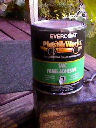

I've used this stuff. It's really great. DO NOT use fiberglass repair, use SMC (Sheet Molded Compound) or you may be redoing the job.
