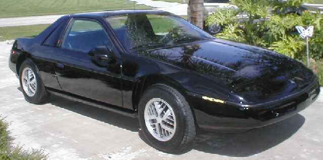

Tweaker
Posts: 149
From: Palm City, Fl.
Registered: Apr 2003
Report this Post06-25-2003 05:56 AM Click Here to See the Profile for TweakerClick Here to visit Tweaker's HomePageSend a Private Message to TweakerDirect Link to This Post
Hi,
I just had a color change from white to black.
I was told to remove all the trim I could to avoid tape lines and to clean out the "crud" under the trim. I removed all locks, the wheel skirts, botom rocker panel (long piece between the wheels), mirrors, headlight doors and the sail panels. (it's a coupe)
The trim behind the lock on the doors required I pull the door skin to remove, it's held on with a screw.
I delivered the car to the paint shop along with the door skins, mirrors and headlight doors.
The body shop removed every other panel and the front and rear facia. the only thing left on the car were the rear clip and the roof.
They preped everything off the car, painted them with 3 coats of black urethane (no clear coat) and re-assembled the panels.
The buffing was done with the panels on the car. It took 5 weeks from start to finish.
I replaced the dew strips, re-installed the mirrors and locks. I can't find anywhere that is not black. I could not be happier.
Here is a group of pictures I took during the process http://www.informx.com/fiero
Hope this helps, Steve
