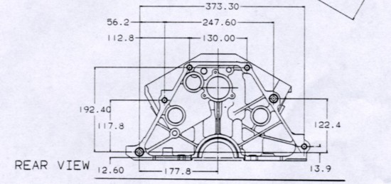

Anyone have a drawing of the bellhousing bolt pattern between the 2.5L and the 4 speed manual tranny from an '84?
Also, would be nice to have the drawing of the 6 bolts on the crankshaft output of the 2.5L that connect to the flywheel.

I believe it's the same as the 60*V6 bell housing pattern, if that helps.

It is definitely the same as the 60° V6, but I can't find that either.
Erikred, if you could post that drawing it would be AWESOME.

How about this
LS1 v8 T-Top 87 GT
[url]http://www.acxunlimited.com/ls1swap.htm [/url]

What are the units of measurement?
JazzMan
Posts: 18612
Total ratings: 653
Report this Post08-17-2003 10:14 AM Click Here to See the Profile for JazzManSend a Private Message to JazzManDirect Link to This Post
Millimeters.

LS1swap,
That is perfect. I drew it up and printed it out. It matches exactly. OK, now let's see if I can make some chips.
