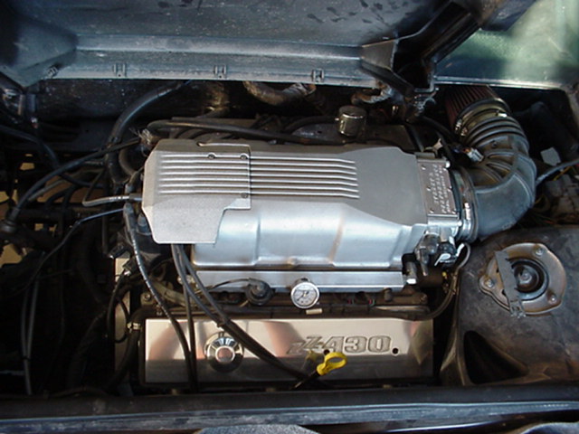

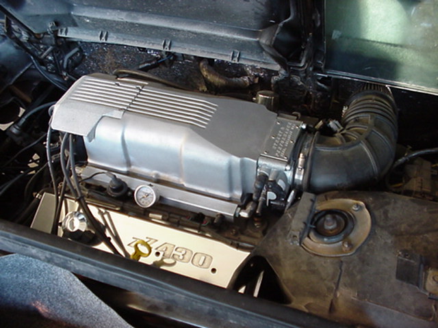

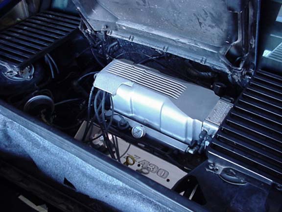

Oh, something else I forgot to tell you......
Remember that big Fuel injection system everyone thought wouldn't clear the decklid???
Anyway, It fits just fine UNDER the decklid.

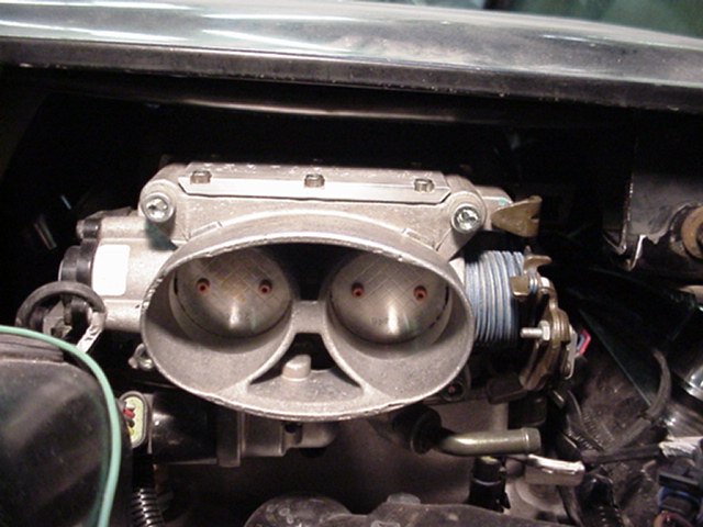

SO if the BIG fuelinjection rig fit under there, what is the usable height from the top of the motor to the deck lid?
Measuring from where the intake manifold sits on the intake oil gally rails to the deck?
Mabey I can go with a larger intake.

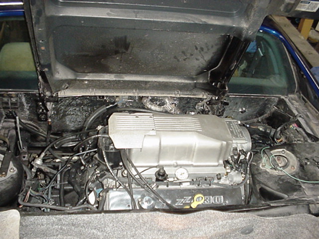

Hey Dave don't break it just yet.... I still want to see it I just noticed something in that pic no MAF ???? Was it air density from the start or did you convert it? Have fun!
[This message has been edited by LS1swap (edited 09-11-2002).]
The setup as delivered from S&P was MAP (speed-density). It works great so far, no need to mess with it.

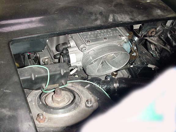

Hi all,
Dave asked me to post to this thread tonight. Today Dave finally had his car 100% complete. And at about 4pm this afternoon he took off for VA to meet up with his buddies and have a little "thing" with his car this weekend.
In other words he & his bud's are all gonna get together and beat on his car this weekend.
Here are some pictures
Archie
Archie
