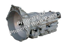

Here is a trans out of a trooper
Here is a trans out of a 3.2 rodeo
Does that bellhousing bolt pattern look familar
[This message has been edited by Erik (edited 02-27-2005).]

Erik
5625 posts
Member since Jul 2002
if the 3.5 is the same form factor as the 3.2 then it should have the same bolt pattern. I wonder if its a 90 degree or 60. Im pretty certain it is all aluminum
That sure looks like a 60 degree engine to me!
