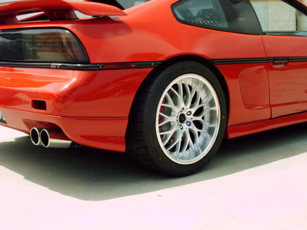

Well, I will be running 17x7 up front and 18x9 in the rear. Offsets in front and rear will be +38 tires will be 225/45/17 and 255/40/18 or 265/40/18. Oh, my rims will be the same as the above picture (HP Design Wheels) in Hyper Light. And yes the 18x9 do come in 5x100 bolt pattern. If you're running the 18x8 (+38 offsets) in front for the '88 it will stick out about an 1" outside the wheel well. Good luck.
Here's a picture of how the 18x9 (that's a 3" lip) looks like without the tires......
Note: Car is lower than what you see............needs to settle.

Report this Post08-03-2005 01:18 AM Click Here to See the Profile for kooljessSend a Private Message to kooljessDirect Link to This Post
OK.....here's what they look like so far with tires. This is the 18x9 with 38 offsets.
Here's the view from the rear.....
Another angle.....
One more......
One more......
Man those look better than anything else I have seen here. Can you post more pics of the front?
That's decent camber.
What size tires are you running?
I'm rolling on 255/40/18 (FALKEN AZENIS RT 615) Rear

Kooljess,
The wheels look great and fit perfectly. Send pics when you have the fronts on!

Kooljess,

kooljess, what exhaust tips are those you got? & Where did you get them?
They are nice!
Another angle.....
One more......
