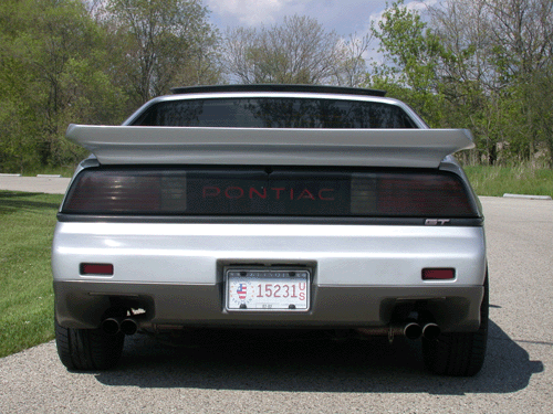

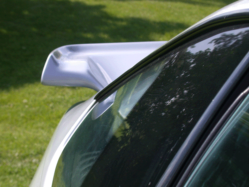

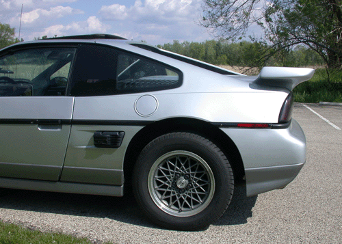

Report this Post07-23-2005 01:40 PM Click Here to See the Profile for OreifClick Here to visit Oreif's HomePageSend a Private Message to OreifDirect Link to This Post
The IMSA spoiler works best. You can buy one from www.fierowarehouse.com
They have 2 versions Notchback and fastback.
Here are pics of one on a fastback: (Gargoyles old car.)

Report this Post07-23-2005 04:45 PM Click Here to See the Profile for goatnipples2002Click Here to visit goatnipples2002's HomePageSend a Private Message to goatnipples2002Direct Link to This Post
Not my taste. That whaletail Spoiler looks out of place back there to me. I was looking for more of a sports car look. Like a sports car you would see on the track. And 400 just for aspoiler.....HELL NAW. I'd rather pay $85 w/shipping for the bomz spoiler.

Here's my "perfectly good car from the factory car"
Stock is fine with me.
