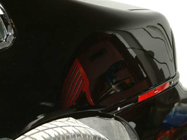

OK ....I give up!!!! I feel very defeated at this point....I went down to a fine cut cleaner and 3M compounding pad....seems to remove the swirls, until I polish and then they return....I then went ahead and wet sanded with 2500 and lots o water....followed by Meguiars heavy cut cleaner #4, Meguiars fine cut cleaner, #2, Meguiars #9 twice and then then three times....followed that with Meguiars Machine Glaze #3.....all of this goes well, but the finish looks just as bad as it did!!!! WTF???
Where am I going wrong here? It seems no matter what I do the finish looks totally awesome in daylight but just sucks with LOTS of lines at night....it looks like I took it through a carwash like a hundred times...this just sucks, I am ready to take a key to the side of the car myself....
After spending serious time and more than a few bucks, I am ready to just cover the damn thing back up and let my 4.9 just sit in the garage...
The paint just seems so succeptible to scratching....I can run my hand across the paint and I see scratches...I am not sure that the "micro-fiber" cloths (meguiars) that I am using are helping at all....it seems like they just scratch the surface even more....I have even gone to great length to label each polishing/compound pad, applicator and towel to identify the compound/polish that is on it....and terry cloth just tears the surface up, even though that is what meguiars says to use.....
Here is what the original looks like looking at it from about three inched away with light directly on it....it looks like total crap, BUT in daylight you cannot see it at all....
and a shot from away a little with light directly on it....
..and another from a distance...
..and another from another angle....crap

I tried another approach .... I went ahead and started doing the aggreesive stuff by hand....it is a LOT of work, but the results appear to be better....I am now applying the heavy cut and fine cut compounds using a non-circular (linear) application until I see no swirl marks....then I polish by machine and the swirls are reduced greatly...after I apply the glaze, glare and wax....
I am not sure that ALL swirls can actually be removed...I have even tried sanding to remove them with very little success...
Also, I went to the Superbowl Winter Blast in Detroit the other day and took a look at the Cadillacs on display....they look worse than my car!!! So I think I may just continue with what I am doing....and maybe not look at the thing at night....or
...I could pay someone to get them all out.....as a challenge....any takers?

Originally posted by Cplensdorf:
OK..I am begeinning to wonder if I am introducing more swirls than I am correcting.....
3800 - exactly what pads should I be using for each step....I am currently using a 3M compound pad for the heavy and light cut compound (white waffle pad), a grey 3M polishing pad (2725, grey waffle pad) for the #9 swirls remover and the glaze....
I have marked the pads and am only using one pad for each product.....although, early on a may have used the foam pad with both the Glare products and the 3M swirl remover....
Also, what is the best method of cleaning these pads....I currently was them under a stream of water (no soap) and let air dry over night..should I be using anything else?
I also am using Meguiars micro-fiber cleaning clothes...these are my biggest concern....they seem to scratch especially with the bound edging....
do you suggest any other products?
Should I be washing the area after each step or just wiping it with a clean micro-fiber cloth? This is one thing I cannot find any info on anywhere?
Ok, Waffle pads for compound only... Smooth pads for polish ,glaze, swirl remover, waxes. Some of the scatches your seeing is the actuall over kill of the product===polish--glaze--wax, when all is done you can mist the car with cold water or Meguires quick detailer to set it. To keep pads clean , you can use a mild soap & luke warm water ---hair shampoo --make sure to rinse well, and spin off the excess with your buffer, then air dry the rest, yep I hate those micro fiber cloths, use (for everything ) 100 % cotton terry cloth---remember the tiles in your guest bath that has your intials on them ?? Not the intialed side--the other side --but both sides of your buffing cloth should feel & look like those. No need for washing after each application. Just buff away the residue.
You may end up with blotchie areas using that kind of pressure by hand, try a compound thats silconic/oil based, Duzall--Pro Bufford . If your using an agressive enough compound and or wet sanding and you still have scratches--something is wrong. Use your buffer on a higher speed, start around 1000 then work your way up little by little until you see results. Don`t go over 1500 for any reason on that type of finish. When you wet sand --are you blocking it ?? If the 2000-3000 grit is not grabbing it, then you may have to go to 1500 grit--be carefull here, just block a 2x2 section until it looks gray, then come back with your compound & buffer waffle pad, its going to bring back your color to a certain extent-- most color will return and look swirley & blotchy--follow this with swirl remover several applications, then several with # 7 glaze ---both with smooth pad. On the re-paint you had they may have let the paint do some srinking on you. One thing I can`t understand in all of this is ---black cars look their best at night or just when the sun is setting ?? The Cadis probally looked that way becuase when they took off the transport coating--some lot tech washed it with a rag full of rocks and followed it up with a nice big agressive wool pad and a all in one cleaner/polish/wax. I see them destroy new cars here all the time. We don`t do any Dealerships, not for any amount of money, they want it yesterday, pick up & deliver, hit & miss cheap shotty work and when the cars gone off the lot --so is the money they owe you... Besides all that we run 7/24/365 and have a overload just retailing out to the public only. See if the above helps out some..

3800 - Wow...it sounds like you have done this a time or two I cannot thank you enough for the assistance here....this is truely an art and I can attest that is takes some time to learn it all....I think things are coming along...I am past the point where I just wanted to bash the side in with a hammer.....you have kept me grounded.....I am going to pursue more of your suggestions and see how it goes....in the end, I think I will have an awesome finish....plus, its about 20 degrees here now and what the heck else do I have to do for two more months....

Well....a little update on my quest for the perfect black finish.....it now looks fabulous thanks to all of the assistance provided above.....just so you know, this is my process for the perfect swirl free finish:
Supplies/tools:
Variable speed polisher
3M grey waffle polishing pad
3M white foam polishing pad solid (no waffle)
Meguiars swirl remover
Glare Spider polish
Meguiars Carnuba wax
Foam applicator pads (one for each liquid)
Micro fiber cloths (3)
Process:
Started by washing panel individually to ensure no latent dust
Applied Swirl Remover to paint in small (2x2 area) with foam applicator (I learned that this prevents the splatter of polish all over the place - I learned this AFTER I got it everywhere)
With grey 3M pad, worked swirl remover into paint using fast broad strokes across area (I learned that I was really working too slow and way too methodical - a random pattern seemed to work best.
Wiped off excess with micrfiber
Repeat swirl if scratches still show under fluorescent light.
With foam pad, did same process with Glare as done with swirl remover.
Repeat glare
topped with wax....
Looks better than it ever did...thanx for all the help.
