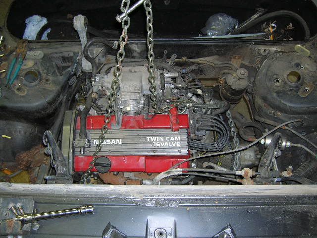

Yeah yeah, I know this is probably going to make me the king of "dead thread" revival, but I am the guy Philphine spoke of earlier.
Since I don't post here a whole lot and therefore am not a "contributor" in the true sense of the word, I have chosen to simply link to a thread that has all of the major links with information on my project (as opposed to eating up all of this site's bandwidth for the next two months by copying all of the posts about my car from Louisvillestreets.com to here.)

[B]Originally posted by Bluemeaniews6:[/BThe only problem I can see is that the DOHC arhitecture would be to wide for the stock engine space. Comments?
There it is fellas... the 1.8 liter, 16 valve, DOHC, turbocharged hotness in a Fiero...
...with plenty of room to spare.
View from the top down, with me sticking out of the sunroof and facing the rear of the car.

I am a Nissan fanatic. And when I mean fanatic, I mean I may have to go to therapy at some point to get over my Nissan / Datsun collectors habit. I have my old VQ30 and non-LSD transmission just sitting and I have debated playing with it in the Fiero. I would definitely put a turbo on it, as I has a GT35 pushing it when it was in my Maxima. That will be a long while from now, as I have a L36 in there now that I am going to play forced induction with. We'll see how that goes...
I definitely want to hear more about your CA18 swap. Positive to you!!
