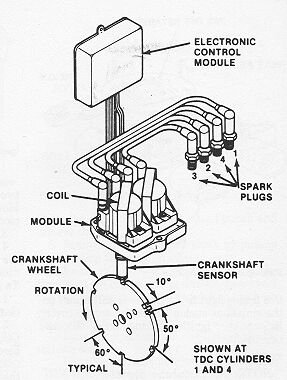

From the archives:
And again with 2 & 3 swapped like Hudini said:
[This message has been edited by spark1 (edited 03-29-2007).]
