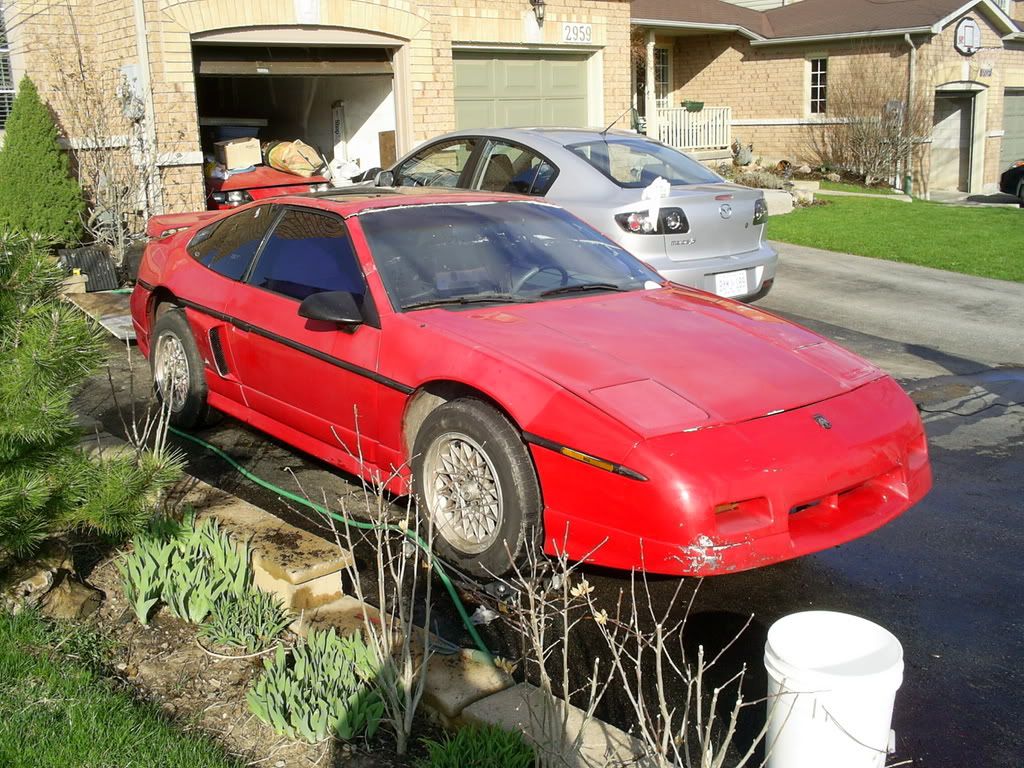

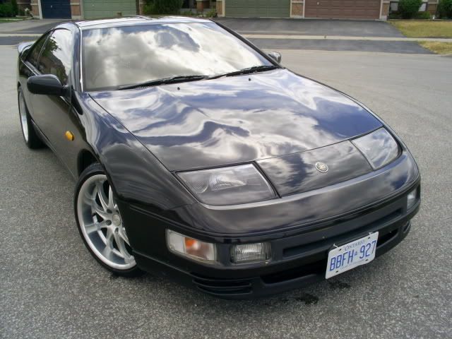

I like the idea...I own a 1986 Fiero GT and a 1990 Nissan 300ZX TT and I know that the Nissan has some serious power without any mods, while the Fiero uuuhhhh.... needs a solid kick in the a$$ to get moving. I think the gearing in the Fiero transmission would be great for the high-revving Nissan motor, but as mentioned above, this motor runs SUPER HOT!!! I can't even touch the intake manifold on the Nissan after driving for only 10 min - you would need a big rad on the car. Also the Nissan VG30DETT is a very wide motor. Good luck with this project... I hope it works for you!
Check out the Nissan @
http://i171.photobucket.com...ZX%20TT/S4020556.jpg
And the poor little Fiero that needs lots of love @
http://i171.photobucket.com.../Fiero2frontpass.jpg
