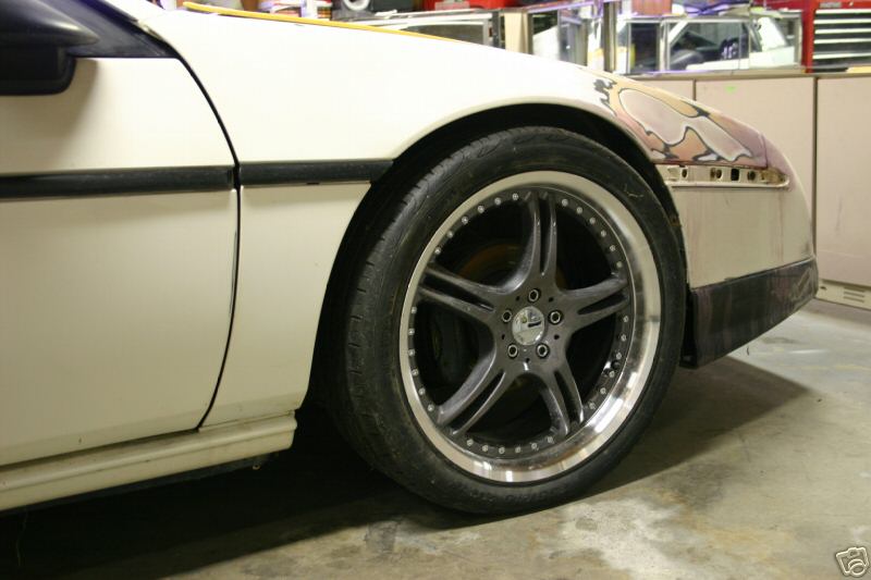

I found a nice set if 18" rims that I plan on buying for my GT and I want to know what size tire I have to get so I don't mess with the speedometer. I would like the rear tires to be wider than the front. the rims are 18X7.5. Thanks
