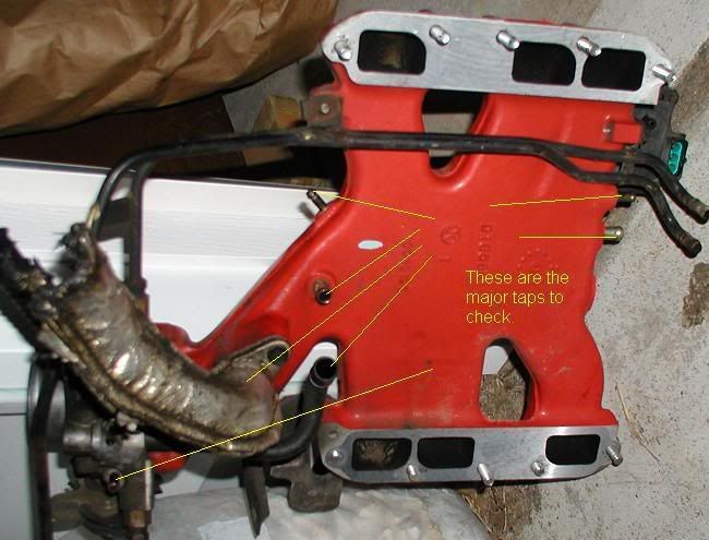

No problem. The EGR is Exhaust Gas Recirculation and is a mushroom shaped device located on the crossover pipe below and to the right of the throttle body. It's designed to reduce emissions by cooling the combustion temps when a small amount of exhaust is allowed back into the intake. The valve is only supposed to open though under light throttle. Idle and WOT it should be closed. If the valve itself goes bad, some exhaust gets back into the intake at idle and causes issues.
The test I refer to blocks the EGR tube that enters under the upper plenum, below and behind the throttle body. By placing something temporarily between the tube and intake you remove the EGR valve from the system. If the car runs better then you have your problem. If it runs the same, then gotta keep looking.
Looks like this:
This is the bottom of the plenum. The EGR tube is shown to the left of the pic. You can see how it connects:
