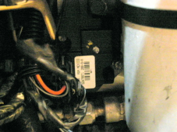

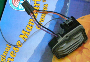

https://www.fiero.nl/forum/Forum2/HTML/099304.htmlFan speed controller out of car
Fan speed controller in car
The A/C braket was modified to allow unit to fit up higher, and a stainless steel plate built to attach fan speed controller to, as well as the hole enlarged in ac housing for the heatsink fins to slide into.
