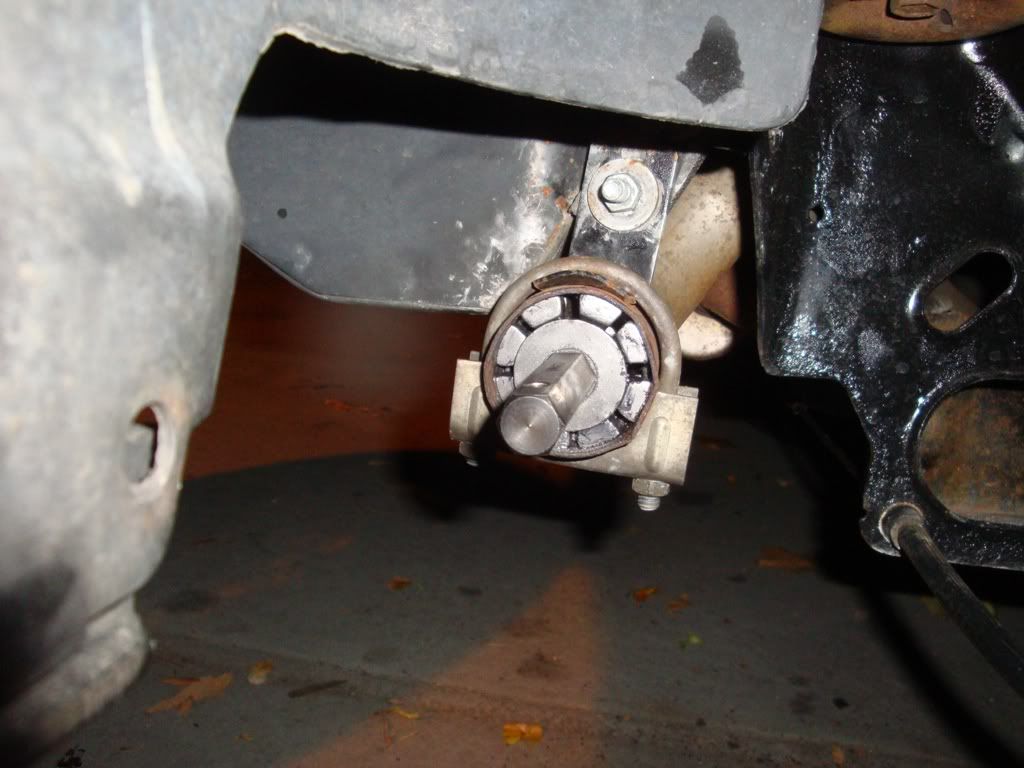

Hi there,
The patient is an '87 2.8 GT.
I'm in the process of preparing the car to pass inspection. Pittsburgh had a rough winter and my exhaust tips rusted away and eventually fell off after driving through many potholes.
I had the car off the ground to change a caliper (finally got the e-brake working), and decided to stretch the exhaust pipe to fit on the new exhaust tips.
The exhaust is the Fiero Store's ocelot exhaust with 2" outlets.
The tips are the polished stainless steel megaphone-style tips, which were bought from the Fiero Store, but seem to be replaced by a different item. They are also 2".
I bought one of these things to stretch the exhaust end (the walls were thinner, so I thought it would be easier).
Just as things were getting good, something happened, and I can't operate the device in either direction. The big problem is, I can't figure out a smart way for getting it out. This thing was well-greased before it went in, but I'm sure a lot of people have said the same thing...
Really! This is about my car's exhaust! Here's the picture to prove it...
Don't worry about the clamp - I had it off when I was expanding, but it was night and I had to put things back together in preparation to move the car... I was able to drive it a short distance to move it to a more permanent parking spot, but the thing stumbles a lot.
Does anyone have a suggestion for an easy way to get this thing out? I have hand tools, but no power tools.
Thanks ahead of time,
Snacktime!

Only way I can think of, is to jentley rock it, back and forth untill it comes out.By the way they do sell exhaust expander and reducer fittings (no need to do it that way), at most autoparts stores (I think I saw them at Autozone).Now that I think about it, rocking it isnt going to work.Can your turn the center nut at all?I would use a breaker bar (no rachet) to back the pressure off that thing (should be counter clock wise).

Yep, I tried rocking it (both gently and violently), but it's really wedged in there.
I can turn the shaft in both directions, but either the nut on the opposite end is bound or the wedge is somehow broken.

Heat the outside pipe?

Loosen it and give the shaft a hit inward with a hammer to disloge the wedges.

1. Hit the tip of the expander up and down and side to side.
2. Put something in the hole that's in the expander and pull.

Cut the pipe off, remove the expander, weld the pipe back on.

You should be able to loosen the expander screw and tap on the shaft to get it out. Next time don't put the expander so far into the pipe.

Only other Idea is to run a thick piece of wire (not copper,thats soft) or cable,through that hole and use something like a comealong to pull that sucker out.Possibley a heavy weight tied to a cable and yank that sucker free.Unless you know someone with a winch and can attach a cable through that hole to the winch...

Slide hammer
$10 that'll just bend the exhaust pipe at the elbow.. You'd need to support the pipe so all the force isn't trying to destroy it.
I just about destroyed one of those things trying to expand a pipe once. Barely made a dent in the pipe - I had to take it to a place with a hydraulic expander (off the car of course, unfortunately for your case...). I tried to return the piece of junk to Autozone but they wouldn't take it. If it won't turn in either direction it's going to be a pain in the nuts to get out without an impact gun..

I agree with the heat suggestion. I think the outside pieces are zinc die castings which should soften and possibly melt at low tempertures.The melting point of pure zinc is about 800F.

6-sided socket of the correct size, and big-ass cheater bar.

I bought one of those tool and my buddy who is s mechanic told me it works better if you don't stick it in all the way and torch the tail pipe prior to stretching it out.
Save yourself the headache and cut it off with that portion of the pipe.

This tool is intended for rounding out deformed pipe, not stretch it up a size. Did you get it out?

the "nut" in the back is "spinning". you need to put a Big "Air Impact wrench" on it & hit "loosen".. I know, you don't have one. bring the car to someone who does.

Yes try the heat thing, If that dont work, remove that clamp, with air tool or drill and small cut-off wheel, cut maybe 3 lines lenghtwise in the pipe to releave the prusser and try all of the above again. Not the reving the engine!

Yes, I did get the expander out. My approach was to tie a string through the hex shaft, and connect both ends of the string to either end of a wooden board. I then put my feet on the exhaust, leaned my back into the sling, and simultaneously hammered the shaft. It took about 2 hours and looked ridiculous, but I got it out.
The nut had split in half. Yes, this was made in China (@ Tha Driver). But the solution was made in the USA!
