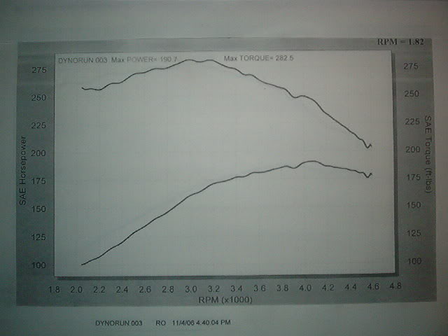

Here is a link for a dyno run on my stock 4.9 with a 4 speed. Use the red and green lines, that is with the VSS to the ECM. The other runs is what happens when you don't have the VSS to the ECM.
http://www.frontiernet.net/~jgunsett/DynoRun.html

Here are a few 4.9 Dyno's I've come accross. Not sure if they were linked in this thread already or not. Just thought I'd add them...
Best run was 190.7 HP @ 4100RPM and 282.5 TQ @3000 RPM. The engine is running super rich all the way throught the rpm band. I'm still running the reprogrammed 4.9 chip but it's for a stock engine. We think I should be able to get it over 200 HP and 300 TQ with some fuel tuneing, just have to figure out what to use. Any ideas??
We didnt have the exhaust gas analiser hooked up so we didnt get any readings. However we set of every exhaust gas alarm in the cell and there was plenty of black smoke and burning eyes. I want to get some sort of fuel tuneing device and go back with the exhaust gas analiser and see what we can do. I started at 180HP and 170TQ and after 3 runs with advancing timing got it to the 190HP and 282TQ. I'm sure being able to tune the fuel will help a ton.

http://img.photobucket.com/...ss29/Oct9dynorun.jpg
Posted in this thread originally...
https://www.fiero.nl/forum/A...050119-1-046354.html
[This message has been edited by Fieroseverywhere (edited 01-21-2011).]
BigGuyTinyCar
Posts: 308
From: Los Alamos, NM
Registered: Jan 2009
Report this Post01-21-2011 10:01 PM Click Here to See the Profile for BigGuyTinyCarSend a Private Message to BigGuyTinyCarDirect Link to This Post
Originally posted by Fieroseverywhere:
http://www.realfierotech.co...3a32c71487349dcd91d7
I was getting my hopes up when I read the top text where he says it's "stock engine", but then I read further down in
the thread:
I'm running the Isuzu 5 speed. Mods are ported heads, ported Allante intake (if thats a mod?), Delta reground camshaft. I've got a MSD Coil, distributor cap and plug wires but dont know if those are any better than stock either.
[This message has been edited by BigGuyTinyCar (edited 01-21-2011).]
