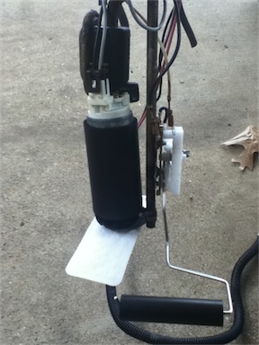

http://www.tanksinc.com/ind...mode=prod/prd276.htmGet the 0-90 ohm unit. On mine the actual white sender is bolted to the universal tube with two screws. We can easily adapt this to our stock fiero sending unit assembly. The original factory sender is attached to it's mounting plate with 2 melted head plastic rivets-simply use a razor blade or knife to cut off the heads which will allow removal of the old sender and leave you the bare mounting bracket.
One inch under the top mounting hole center, you will have to drill a new 9/64 mounting hole for the universal sender to mount.
I used two small stainless washers between the plate and the new plastic sender to space them off the plate so the float arm can freely move.
Your stock wiring will transfer over easily, you may have to slightly open one of the push on connectors with needle nose pliers.
The universal sending unit kit has a long straight float that I bent into the shape of the original.
