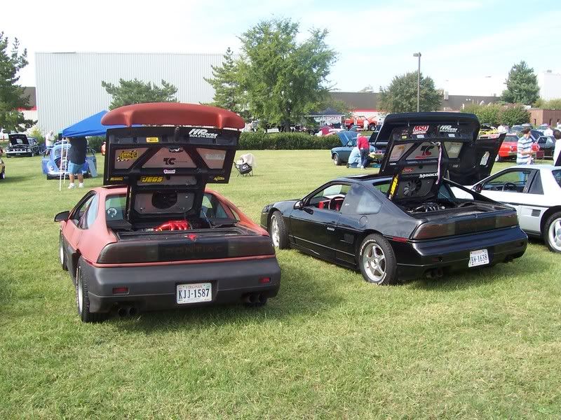

I like the satin black also and used it along with aluminium to do my modified deck lids. LOL that and lots of aftermarket High pro product stickers and such. Not to everyone's liking I 'm sure.
