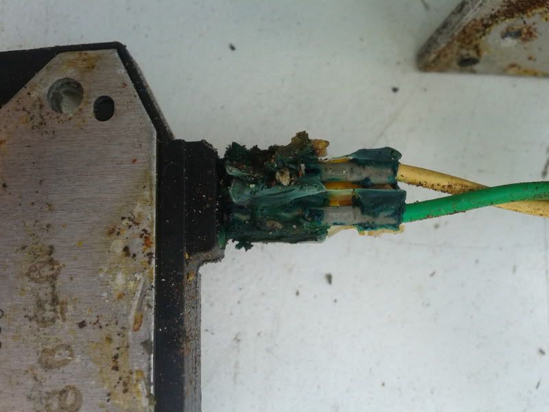

I checked Rock Auto for a new ICM, as the ones at AutoZone are $75.
RA had some there for as low as $2....why are they way way cheaper? There were also some for $20.
Which ones should I buy?? They all seem the same to me.

Report this Post05-28-2012 09:14 PM Click Here to See the Profile for Dennis LaGruaSend a Private Message to Dennis LaGruaDirect Link to This Post
The best service has be acheieved with the AC Delco modules. When putting it back on you must use a thick film of heat sink grease on the bottom of the module before you bolt it down. Electronic part stores sell it and so does Radio Shack.

Originally posted by FireGirl:
Ha ha on mine, those plastic clips on mine were entirely melted away. They were gone! The terminals from the pickup coil were just poked onto the tabs on the module.
I decided that was reason enough to pull the distributor and give it a nice new coil and module.
