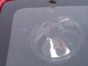

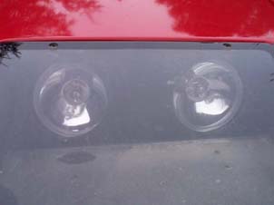

Someone wanted the pictures of my headlights, could you please E-mail me, I lost your address

I think there are a few other Fieros on this site that have similar lights, but I will show you the pictures of mine anyway.

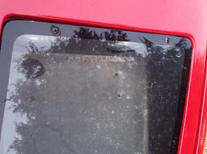

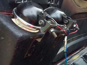

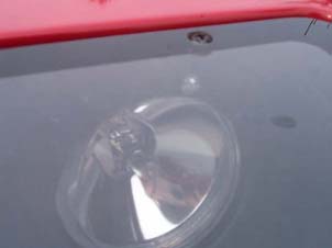

When I first got the car the right motor in the lights was screwed up, I guess it was the gears in the motor. I looked around for motors and found out that for the price of having two motors replaced, thought it was beter to replace the other one also, I could have this done.
There is a guy in Newport News that does work on Fieros, he was the one that put them in.
I can give you an idea of how they are put in. First he had to take the lights and motors out of each side of the car. He had these buckets made, thats what takes place of the light assembly. The buckets are mounted to the top of the boot with some kind of putty or glue on 4 corners of the bucket. Two holes are cut into the bucket for the lights. The lights are hooked to the buckets by brackets and then set to shine out of the two holes. That is really about all he did to install them. The lights are hooked up to the old wires.
There is a catch though, they are not leagel, as you can tell by looking at them. You can't adjust them, and they are always on the brights. I guess the reason they are always on the brights is because he didn't know how to hook them up any other way. I am getting ready to have a guy hook them up so that when I turn on the brights all 4 come on and then off the one on the outside go off.

I would like to know if he will sell just the buckets..
I have a design idea involving some Grand Prix headlights..and thos buckets just might work...

are those 4" lights?
Yea they are 4" lights, and I will check to see if he will sell just the buckets for the lights or not.
