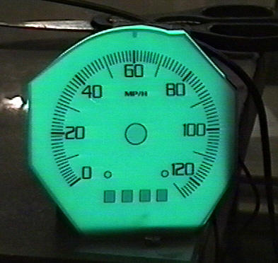

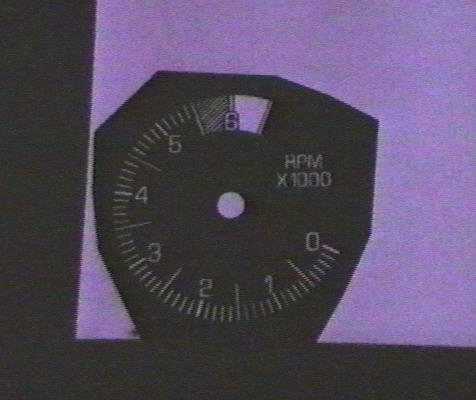

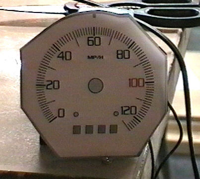

I finally got the correct EL material for the EL guages that you may have seen on other cars. I will be producing them for sale very soon.
These faces are from MinnGreen. I'll be posting the MinnGreen "checkerboard" face design later
Its not easy to take pics of this stuff...but here ya go.
Room lit, face off(dark pic)
Room lit, face on.
They are very bright but will dim with your stock lights.

Oh, don't mind the dark edge(right). The real ones will be lit there

Just 2 quick questions. What all will they replace? Speedo/Tach aux of course/ What about the HVAC controls? And, green the only color? Orwill other be avialable?
BTW. That looks down right schweeeeeet. I will definantly own once I have a Fiero with a working engine

OK... let's see where to start.
Spiff- Nice Car! For the cover I'd probably have to scan it myself (there are some issues that occur when blowing up a magazine print a large scale). I have the capability to print posters anywhere from "small" ($25 approx 12"x24") a "standard" size is 2'x3' is runs $50, and I have the ability to run up to 60" wide by whatever length you're interested in. Email or PM me... there's a handful of info here as well: https://www.fiero.nl/forum/Forum1/HTML/013564.html
For those looking for the standard-style gauges with different colors... I just realized that Joe may be able to make them faster & easier than I can!
Joe- do you have a thin semi-transparent colored film/material you can use? If you simply placed your black "reversed" gauge face over a white layer... then stuck it on the colored layer (so you've got the black on top, the white in the middle, and the color on the bottom). It'd look simliar to the current gauges (white characters when not lit) w/whatever color backing film showing through to the front! I'd be far easier than what I can do.
The question of custom designs & colors... again we're going to finish the "normal" stuff 1st, then we'll have to see what we can figure out colorwise from there. The custom printed faces won't be much work- really just editing a design.

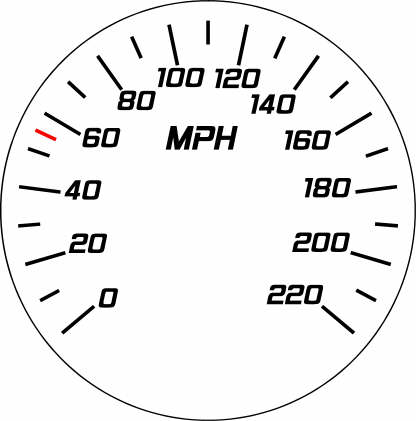

Also for 150-200mph speedos... if someone has some exact calculations on this- please let us know! If you can figure out what crystal to use... and what degree angles specific speeds land on (where's 55mph, where's 85mph, etc...) Then we can make those faces as well!
87ECO5- The design shown above is a white-faced/Black lettered design (OK.. so the 100mph mark is red ). The photo is just rather dark... we'll see what color combos they have EL available in.
Keep in mind that the only EL paper that is white when off is the WHITE->GREEN as shown above.
