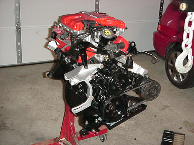

a few pictures of mine taken during the rebiuld. Looks SO MUCH better in day-light, I am happy.

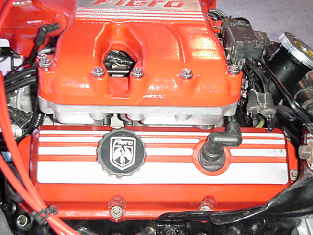

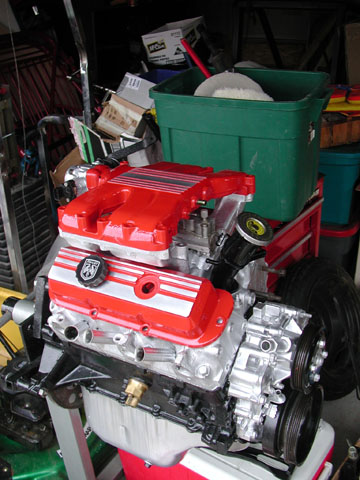

Here's a pic of my 2.8, I ran out and took a pic, please excuse my messy garage.

that looks great! is it all painted, or are there some polished parts too?

It's all painted, with spray-can heat paint from Canadian-Tire, except for the tops of the valve covers and the plenum. There I took alot of fine wet-sand paper on a wood block to achieve the shine. I then used polishing compound on a towel to finish the bare aluminum. I have a new Rodney Dickman "Fiero GT" decal for the top of the engine.
I used:
-CanadianTire 500+ degree black engine enamel
-CanadianTire 1200 or 1400 degree aluminum manifold paint
-Canadian Tire "Ford Engine Block Red" (don't flame me) 500+ degree engine enamel for the valve covers and plenum.
I used the "Ford-like" Color because it was VERY close to the factory orange/red, and all I could get in a GM color was red or orange.

doesn't matter to me if it's ford or not, it looks good.
do they have metallic engine paints available?

I'm not sure if they have metallic paints or not. For some reason I think they might have silver and gold. I know they have metallic rim paint, but that wouldn't withstand heat very well.

Awesome, the engine looks great I was looking at their paints tonight while picking up some tools for the head gasket job, looks like another trip to CT this weekend(it's like a block away, it's great)

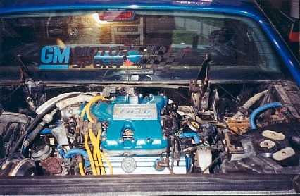

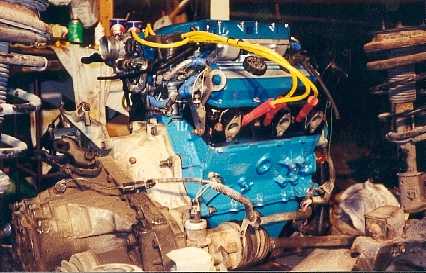

here are some of my butchering
blue 87gt, loaded, mr mikes interior,OZ f1 plus rims, and a wee bit of TLC within that bad a$$ v-6, and now RCC coil overs wheeeeeee

WILLAKERS, It's so shiny, looks good, hope mine will turn out half as good(seeing as it's only 2.5), we'll see.
