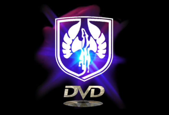

Had to bring this one back up - I finally got a 1meg player and flashed a really cool Voyager startup screen onto it, but would LOVE to get that Fiero logo on there.... Did the file ever get posted, or is it not being let out of the bag? I can't WAIT to get this thing into the car!

FWIW, I've developed my own personalized Fiero background for my DVD player. I haven't flashed it yet, but will be getting the file sometime in the next day or so. Here's what it looks like:
David, if you would be interested in using this image on your CD, email me at gjones72@earthlink.net.

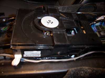

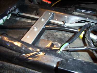

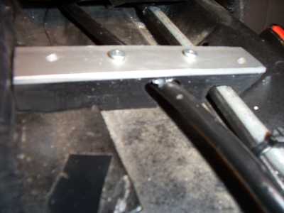

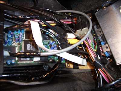

Sorry for the delay Greg: Here you go. It still needs some cleaning, but I havent had time lately.
I took these about five mintues ago so the light isn't great. let me know if you need more. Also I wasn't on marcro so there kinda fuzzy.. Ah well I realized it by the time I took the following pic.

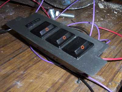

Heres the ON/OFF toggle switches I've been working on.

Tried like hell last night to get the drive in the center console. I'm having quite a bit of problems. Did you cut the underside of the center console out to aid in the clearance for the drive? I've taken all the insulation out, but haven't cut into the plastic yet. Does the DVD drive mount on your plate in the front and basically rest on the bottom of the console in the back? Everywhere I placed the drive last night, I had problems with the drive catching on something when it opens and closes. I'm sure you've noticed that when the drive opens, the section with the laser and motors drops down. It got high-centered everytime. It may prove to be a problem later on, but I even tried cutting the mounting feet off to try and decrease the overall height of the unit.

Yea it took a while to get it to fit and work right. I'm still working some minor things out. I'll explain later.
The front feet rest on the plate and the back two feet rest on the metal console about 1cm from the bottom. This provides the angle or driveclearence for the shift console surrond. You need the feet of the drive or similar to provide the clearence for the laser like you stated.
I had to remove all the foam and I removed a square section of plastic from the console. The problem with this is it doesn't provide any support for you elbow extra. So you have to slide a piece of sheetmetal in. I used the top of the apex player, It works oK, but I'm looking for something a little thicker.
I found that there is a certain spot where everthing will fit. It will take some work but you'll get it right.
BTW if you think getting the console to fit is hard, wait to you try the flip down door. hahah
The problem I'm currently facing, is that the console moves around slighly when weight is applyed to the top. SO basically it will work for a few days until it shifts, then the cd drive will get stuck. You give it a slight tap and everything works fine. I plan on making the console a little more ridged and everthing should be great.
One last thing, make sure you glue the litte tape on the video card ribbon cable down. It can pop off and cause many problems later on.
Good Luck.
