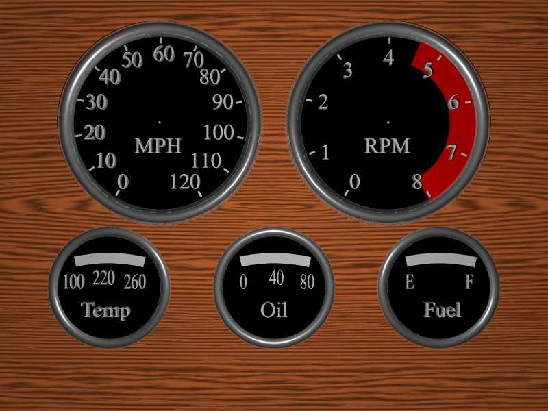

Well I don't know about reinventing the wheel, I am just doing this for fun, learn a bit of new stuff, be different etc. It may or may not work, or even get finished, doesn't matter really (to me anyway).
Just for interest, here's the latest incantation of my insturment panel GUI:
Dave
http:www.ltlfrari.com
