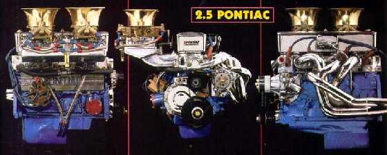

I've got a 4spd, the one with the final ratio of 4:10, currently the car has the 5spd manual in it. Cheap way to change final gear ratio is to have a couple extra rims with lower and taller tires. I realize that the current tranny options are the limiting factors as far as all out high torque high hp motors from a standing stop. I want a reasonable 0-60 time and maybe try to get into the low 14's quarter time. Starting with a SD block, head, and crank, 200hp seems to be easily attainable and would be strong enough to take a shot of n2o if you wanted to add a little more. It would be an expensive build but when your looking at over a grand just to get the V8 kit and then finding a decent used motor, wouldn't you want to rebuild it also? Same with the V6 swaps, sure you can find a reasonably priced V6 with the harness fairly easily but you do take a chance if you don't rebuild it before throwing it in. I don't think I've ever just swapped a motor into any vehicle I've ever owned, always go through it and improve it before loading it in. The SD-4 is what won big in the imsa GTU class, it has a great reputation for long term durability in applications pushing the 250hp range. I saw a post a while back where someone had a few of the actual SD motors, anyone know whats going on with him now.

I've looked into it and it can be done but a SD4 will run you 6000+ depending on what you want for "go fast" goodies. You can gat a lot of HP out of the SD4 without the weight of a SBC but at a premium $$$$.
