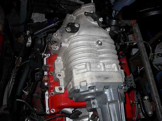

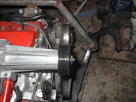

Just for kicks I took some pics...
Its not a fiero V6, but rather a 3.1 from any FWD Gen II. It would fit a bit better if it were a M62 Supercharger instead. I had already Decked the plenum to be flat. I would have to weld an aluminum plate to catch the bolts around the outside. The reason it is ofset to the left is that the plenum has a small airbox inside it, approximatly the width of the outlet on the Supercharger. That is where its located. Maybe one day I will make a Fiero V6 plenum with a supercharger in mind. But I have othere projects, My DOHC primarily.
