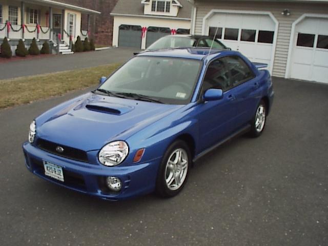

I know the bolt pattern is the same but I dont know about what offsets will fit a fiero. It seys New set of 4. 5x100 offset 48... Will this fit?????????????

One of the forum members has them on his car. He had to have the centers opened a bit for them to work. Im sure if he sees this post he will reply and include a picture of his car with the wheels mounted. Are these the wheels you are talking about?

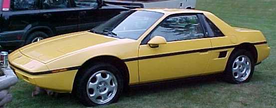

these were Subaru rims on my 84, I no longer have her and I don't remember the offset at all, they did however fit fine...after I took the pic, I had 225/50/15's put on the rims which filled the wheel gap and handled tons better
