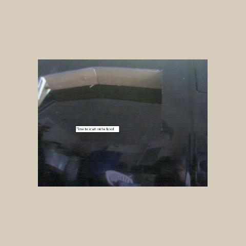

ya, the link works, looks like you have your work cut out for ya, my hood is exactally in the same stage as yours is in the pic, io just need a few hours to finish mine but i cant find any free time

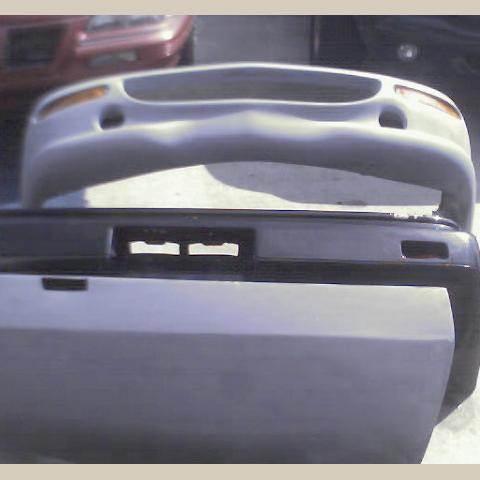

No more as of yet... But can get a few shots this wekend.
This is as far as I have gotten so far.
Still need to do the pass. door, and finish filling the trim on the rear. Hope to finish filling the rear facia this weekend.
Sanded & filled the the driver side three times so far & am still not happy....
Long way to go with the sanding.
Did you fill in your side runnnig lights? I think I will. Going to shoot the car in black again, so sanding will be critical.
My hat is off to you!!
Best wishes.
John

Here is what I did.
Used Dremel to grind down area where filler is going. Cleaned & started layering in fiberglass cloth & saturating it with resin.
Built up layers as needed to get the height I am looking for. Covered that with bondo to get smooth & sanded, & sanded.....
Still have some "air bubles" / pin holes to fill with bondo.
But that is mostly how I have doen it so far.
When I do the pass. door, I will post a detailed step by step photo shoot.
Just going to take a little time.
John
