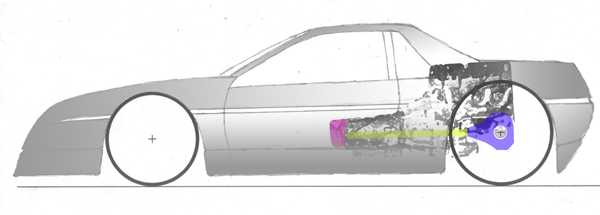

Thought about it but that idea was shot down too Gerald. It would be a very very loonnnggg stretched car!
Look how far back on the transaxle the axle centerline is!
As compared to a Porsche:
perk - todd's hot rods

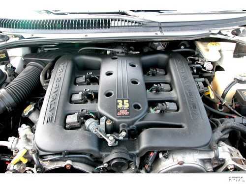

Here is a tip for you perk. All the new 300M's and sebrings use a longnitudal style 4 or maybe 5 speed auto trans axle. The engine is mounted normally driving the front wheels. Very compact setup and the 300M already makes 265 HP and around 300 Ft/Lbs torqure. Would make a very nice tranny if electronics arent to complicated. Light weight too since it is aluminum Here is a pic of how the motor is mounted.

Hey Bryce, just more research here. After I got the car stripped down I started doing some measuring and planning. One of the main things I had to look at is what I want from the car, and where it fits into my business plans. There are some big changes coming which will make the project much more radical.
I am going back to a stretched wheelbase and have decided to bite the bullet and run the Porsche transaxle. Remember my initial threads about a 108" wheelbase car? That's where I am going. I went around in a big circle to end up back where I started but now I am sure that is the right direction for me cuz I have seriously considered every alternative.
Some of the things that made me want to build a stock wheelbase car was the desire to keep as much of the original essence of the Fiero in my car. I have determined that it is more important to me to meet my performance goals than to build the ultimate Fiero - I would rather have what I consider to be the ultimate CAR. I realized that I have to be really happy with this car when it is "finished", or all that work will be for not. I am basing it on a Fiero because I believe it is the most logical choice.
Hey red85gt, I actually considered the Chrysler transaxle too. My outrageous hp/torque goals are the problem. I know the GM TH325/425 transaxles could be built to handle the torque, as well as the Porsche units. I don't want to get into developing a transaxle - I want to develop the car.
Thanks for the tip though.
fieromadman - it is a racecar, but it must be a street-driven racecar. A part of the thrill is that it can be driven around on public roads legally. To really get the most out of it I have to have a passenger seat! I mean what fun would it be if I can't share the experience with people - in real time! All that is to say that the tank can't be there, cuz I wanna take people for rides. Since I am going with a stretched wheelbase now I can actually move the tank behind the cabin and run air down the middle! The suspension will use a few components from other cars but will be a dedicated design - not just transplanted Vette stuff. The control arms (front and rear) will most likely be all custom parts - either tubular or billet. The front uprights may be C5 units. The brakes will be C5 brakes and eventually aftermarket replacements for a C5.
Again the reason for searching for as many "off the shelf" parts as possible is to avoid engineering a thousand new parts, and concentrate on building a car.

LOL! I had to do a lot of soul searching, a lot of "mind changing" and eventually I was able to find myself and my cars!
There were two cars in head! That's why I kept switching - sometimes it was one, sometimes the other, sometimes a garbled mess of a mix of the two (say that three times as fast as you can!).
On one hand, I love these little buggers! Every time I try to walk away from them I come back to them more fascinated than the last. That side of my brain wants to build an ultimate (93.4") Fiero.
On the other hand, I have a vision, if you will, for an ultimate street-legal race car - hence the stretched wb, tube chassis concoctions. It's really not a Fiero, but it embodies a lot of Fiero characteristics; so my love for the Fiero kept pushing me to make it walk like a duck, talk like a duck - but it ain't no duck!
Hope you're getting my point - there really is one in the midst of my silliness.
The solution? Build a 93.4" Fiero now and keep simmering the "ultimate car" idea on the R&D/design back burners, then use the lessons, technology, and connections learned and earned to build that "other hand" car in the future.
As for all of the other choices I had to make, they revealed themselves by simple process of elimination.
Engine - I am using a SBC to set up, and get it running - because I have one and they're cheap and easy to deal with. Allows me to keep the money where I need it for now.
The final choice, however, will be an LS1. It's lightweight, trick, powerful, and efficient - perfect! It's mainly that 6-bolt aluminum block, fantastic 13* heads, and the EFI, that settled the debate. It's a hard package to beat IMO, and the aftermarket (though still kind of pricey) is growing fast and furiously.
Suspension is gonna be specially (CAD) designed for the car. The company that is doing it hopped on board as a sponsor. They're waiting for numbers from me as soon as I finish my research. SLA at at four corners, with coil-overs. Will be designed to sit the car about 3" lower.
I would be building the car by now but we have been working overtime on building a new shop. Don't worry - no more switching, I promise! My sponsors wouldn't like that!

So have you made a "final" decision on a tranny? I know you've been hanging around the Toronado tranny thread lately.
Bryce
88 GT
perkidelic
Posts: 772
From: Masury Ohio USA
Report this Post07-27-2003 10:17 AM Click Here to See the Profile for perkidelicClick Here to visit perkidelic's HomePageSend a Private Message to perkidelicDirect Link to This Post
Yeah, it's an extension on the Toronado transaxle theme. I am going to mount a convential front/rear transmission to the motor and sit the whole chabang in the car reversed, with the transmission extending forward between the seats. From there a tranfer unit sends it back to a short differential mounted similar to where the Toronado diff would be. Same basic layout from there to the wheels.
The advantage of my idea is that I can push the engine a little further ahead for a little better balance/weight distribution. Plus, I have more weight towards the front because of the transmission. The biggest disadvantage is that I will have to at least partially move the tank forward. A necessary evil IMO. I want the ability to run stronger, less rare, transmissions.
I am using a TH350 to set the car up, but my ultimate goal is for a Richmond 6spd. That's about three grand in the future though. I chose the TH350, again, because I have one; and because it is a common size which will allow me to relatively easily change to something different. I plan to drop the motor and tran in someday soon to start on the mounts, etc. Then comes the roll cage.
As for the transfer unit, at first I was going to use a v-drive type unit from the marine world, but then decided to make my own. I am going to mock the case up in wood and sand or investment cast in in aluminum. The gears will likely be two heavy duty transmission gears. I plan to take a ride to my tranny guy soon to see what he recommends. Hopefully I will bring a couple gears home too. I can turn the shafts myself and have them welded up. Same for the three driveshafts, and one intermediate shaft, that will be needed.
All that to say this:
perk
