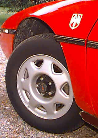

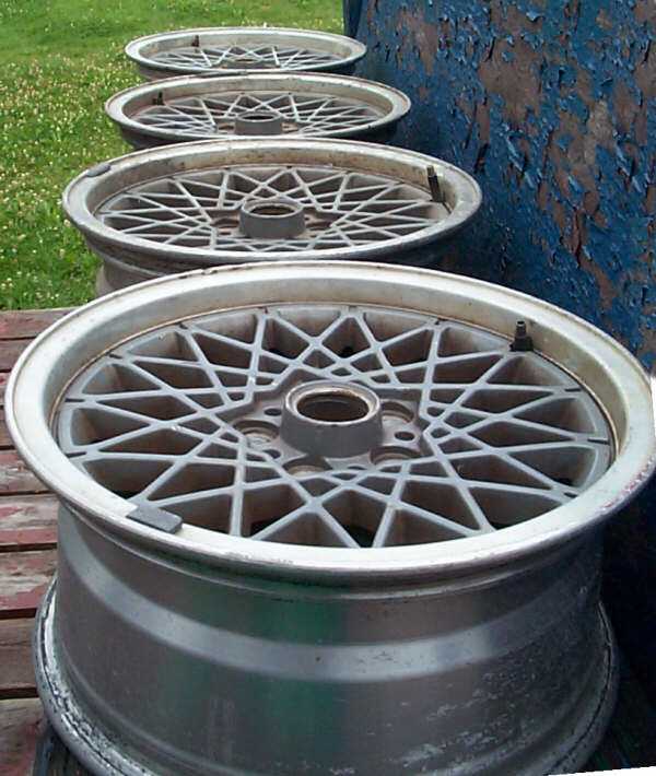

For anyone who doesn't recognize these, they are 86/87 Fiero GT 15"X 7" wheels. This was the surprize that Steve has been hinting at in his earlier posts. They just showed up, no charge Talk about Christmas in July (OK so its August).
Steve, you have changed the whole complexion of this plan. Too bad I can't give you even more positives.
The next step in this project (as soon as the hood is finished) will be to polish the rims of these beauties and touch up the paint.
Thanks again to Steve and his accomplice, Bob Parker at Kick Hill Farms.

Question: How would 195/60X15 fit on the 15X7s? A little lower than the 195/70X14 I am using now, but that should just improve acceleration.
I lost my chart for matching tire sizes to wheel width ranges, (example, 215/60X14 fits 5.5" to 8", wider or narrowere not recommended, usual fitment 6") Does anyone have a link to a site which supplies this information (I just want the generic, tire size to wheel width, not specifics about particular wheels or tires.)?
I want a good handling package, I will eventually use wider rear tires, but for now these tires are available, any comments?

Thanks Fieroso, the 15 X 7 wheels give me a lot more options. Stock these would have carried 205/60 front and 215/60 rear. The problem with the light switches is that there is no circuit breaker built in (the stock switch has a safety device built in). I may check which circuits need protection and add a little inline fuse block.

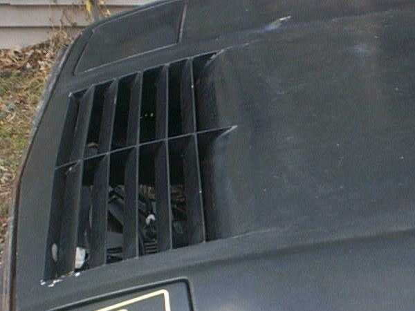

Still wondering, does anyone know anything about this? I asked before but got no response.
It seems to have a relocated radiator, and some modification to the nose (facia is missing but the structure looks modified as well). An interesting design, definitely lots of airflow.
And then for the hood vent you've shown, I recall that it was on the choptop car that Philipene purchased from FieroDave... that's about all that's known. Ah, here's the post too (looks like one of yours from awhile back): https://www.fiero.nl/forum/Archives/Archive-000002/HTML/20021104-1-020242.html you might want to contact him directly and see if he knows anything else about it.
Thanks MinnGreenGT I had forgotten that one, you are definitely master of the search feature. The tire calculator is a good one but I was looking for a chart which relates tire size to rim width.

Great thread, Ira. I've been following your build up since you started a few years ago on the Fiero.org list. It's great to see it all in pictures. The car looks nice!
About your tire size vs. rim width question, I sort of have an answer. http://www.tirerack.com has "suggested rim width" for their tires. You could check out a bunch of tires on there to get an idea. That's the best I can do, though, I've never seen a universal chart with just this information on it.

Doug, I have a Bridgestone tire brochure around here somewhere which gives the recommended wheel widths for a great number of tire sizes, those that are not there should be easily extrapolated from the data in the chart. If I find it I will scan it and either OCR the info or post the scanned igame, I doubt if Bridgestone will get upset.

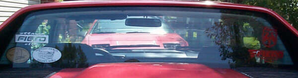

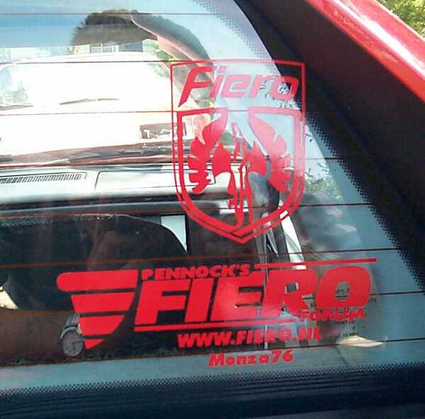

More good stuff in the mail today, just received my Pennock decal from Joe Torma. This is a low cost item, and some of the money goes back into supporting the forum.
And they look cool:
Yes some of the letters are crooked, I really need to be more careful with decals.
Here is my back window now, this is the limit, any other stickers go inside the decklid:
Thanks Joe
Ira

Hey Ira, in that last pic of the rear window showing your decals you can see another red car in the background thru the windows. Is that another Fiero? It looks like maybe another Fiero with flush mount headlights and the hood looks like the one you are doing the vent on?
Kruz got it, that is my 1984, it is non functional at the moment (maybe a project for the distant future). The hood is my vented hood, I am using that car as a workbench, test fitting platform. I took the headlight doors out of the hood while I was working on it because I didn't want to break them.
Ira

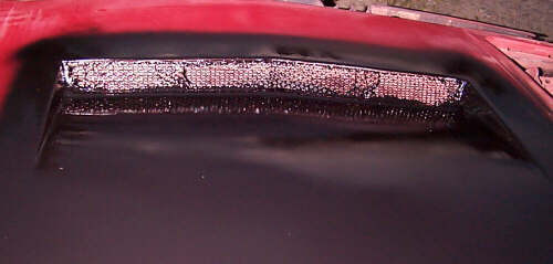

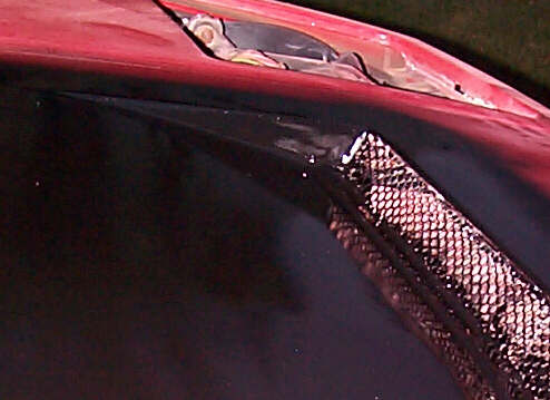

Man I really have to learn how to do body work right
Here are some pictures from today's misadventures: Looked OK but add paint and.... You can really see the problem here:
When the paint dries I will sand it all off and try again, well my first Bondo experience must have been a great learning experience, especially if we learn by our mistakes I'll try wet sanding first, just to see if it helps, and then I will paint the grill black (this should look better)
Meanwhile the wheels are soaking in another shot of Permatex, the rims will need some serious polishing but the centres are looking real good.
Well at least the hood look good at 10 paces
Ira
[This message has been edited by Monza76 (edited 08-16-2003).]
Anyone have any suggestions? I figured I would sand off most of the paint, smooth out the surface and try again. What do you guys use to sand tight corners?
Ira- looks like a good start. Some of those tight corners are a real PITA, aren't they?
For something like that, I'd do most of my "shaping" with a dremel using a 'glass cutting wheel and/or a sanding drum. For "finer" work you should probably just use a small piece of wood wrapped with sandpaper (of whatever grit you need at the time). Lot's of time involved there. Looking back, it would probably have been easiest to do the sanding & shaping prior to installing the mesh screen. Doh!
My only other suggestion at this point... sand, sand, sand... and maybe sand a bit more until it's right Just keep working it until it's where you want it to be.
If you do lay more bondo, you can always help shape it before it kicks by pushing on it with a flat surface covered with wax paper (the wax paper will peel away after the bondo sets, and the surface will be much smoother. Keep it up!
Thanks Rob, wish I had known about the wax paper trick before I started, I'm always in too big a hurry. I think I will leave it until next week now and concentrate on some "around the house" issues. I really like the way it looks, All I need now is to get the details right.
When I get back too it I will sand everything down to where it is right and if there are then holes, I will try the wax paper trick. I see what you mean about the grills, I should have done the top first and then fiberglassed from the bottom, after all the aluminum gave it strength, the fiberglass was more to keep it all together (including the grills).
I have a dremel and a similar low speed tool which has a reciprocating feature, great little sander with that one.

Well, I have been using a dremel with a sanding drum for those "tight" corners down near the openings. My scoops is alot smoother but still a little rought around the edges. I'm trying to get all my projects on the car done rough right now and go back and smooth it all out. Also Ira it didnt look that back on the grill. Maybe on the grill you could take a drill with a small drill bit and run it through those holes in perfect all the misconceptions. Either way its good to see what you've been doing, Ira.
'Low odor aircraft remover' works the best for me in stripping wheels. And for those tight corners check out the Mega Mouse detail sander. http://www.craftsman.com Check out the 'cool new tools' too.
Well, I didn't sand down everything but I did work on all of the irregular surfaces. I cleaned of the aluminum strip and have it smooth now, and I sanded all of the edges again. I was thinking of getting some glazing putty to smooth out the rest and then a coat of a scratch hiding primer before the colour. The colour from the rattle cans is not a perfect match because of the degree of fading on my car, so I am going to paint the entire centre section of the hood, that way the colour difference will be a little less noticeable.
I don't think there is any point in posting a picture right now, but I will as soon as it is painted again.
Hey Ira, I know you usally give me the tips but if you goto walmart or somewhere and buy a paint stripping sanding disc. The bigger ones they solve all your uneveness problems very quickly! I learend that the hard way, so now shaving the trim off is so easy its like baking a cake on a cooking show!

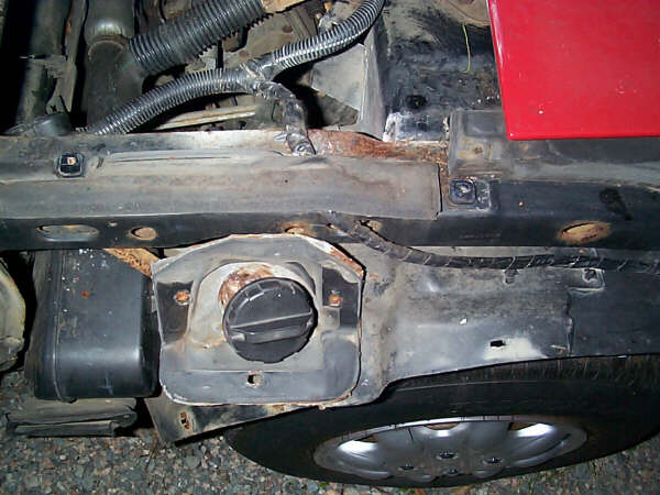

Major surgery, I have decided to remove the rear clip in order to replace the fuel filler neck. Since this will expose the upper frame rails I will get those repaired at the same time, as well as the ends of the trunk.
Since it will be in pieces, may as well take the opportunity to replace the rear struts. I have three weeks of holidays left, hope I can get it all done in time. Once the structure is fixed and the fuel filler replaced I can turn my attention back to the vented hood and those marvelous wheels from Steve.
Anyone who has done this work before please check in with any suggestions which could make my job easier. Having a parts car to work on certainly helps.
Ira

Major surgery, I have decided to remove the rear clip in order to replace the fuel filler neck. Since this will expose the upper frame rails I will get those repaired at the same time, as well ass the ends of the trunk. Since it will be in pieces, may as well take the opportunity to replace the rear struts. I have three weeks of holidays left, hope I can get it all done in time. Once the structure is fixed and the fuel filler replaced I can turn my attention back to the vented hood and those marvelous wheels from Steve.

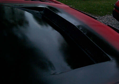

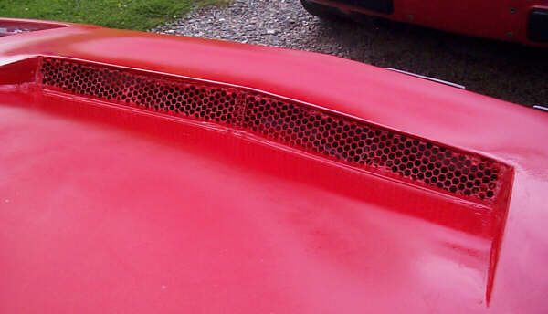

I covered the offending area with glazing putty and then sanded it all off so that the surface was level and smooth with all of the scratches filled, then I used a thick gloss black paint which would fill the smaller imperfections and , because it is gloss black, will show if there are any more problems. It was late in the evening and the black paint I was using was still a little wet but here is my vent as it looks now:
and this:
And here please note that it is the reflection from the flash that makes the grill shine, as you can see in the second picture, it is black:
The hood will be painted red, the black paint is a good scratch filler and will be left on the grill but the rest will be sanded down and painted red. There are none of the irregularities now except in the tight corners where they are not noticeable. I will sand the black after it has had a full week to cure and then I will add the red.
Hope this meets with approval, I realize I have taken a different approach to this project but it looks like it will work out.
