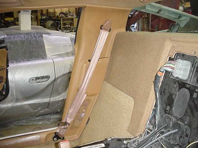

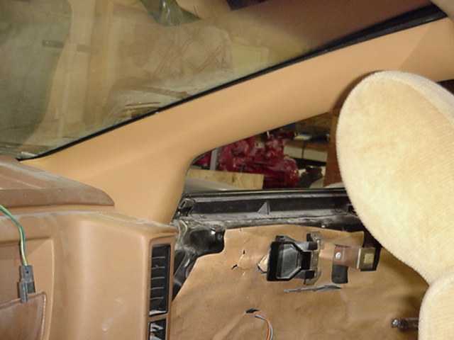

Someone asked what the interior panels looked like.
When chopping a top you need to modify the interior panels too. On our chop top we now make these parts out of fiberglass and sand & paint to match the interior.
Archie
