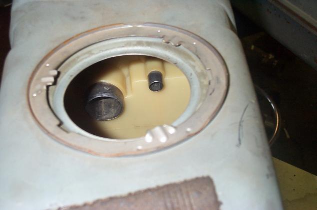

I was in the process of fitting an 88 tank into my 84 (and it's not all that complicated either. Some say it cant be done without major modding to the frame and bla bla. NOT SO) when I noticed something interesting.
Inside the tank (through the pump hole) I saw the filler and vent tubes. The vent is just slightly higher than the filler but it's also nearly 3 inches from the top of the tank.
By adding a preformed piece of tubing to bring the tip up about 1/2 inch from the top of the tank (any higher and it will force fuel up the evap vent line) you will add atleast a gallon more gas!

Heres a pic of the inside. All we need to do is get that vent up a few more inches.
I was thinking of cutting a hole in the plastic bafel near the top and reposition the metal pipe would work perfect. Stepping on the brake when the gas is below the vent tube will definatly be more than enough to drain it.

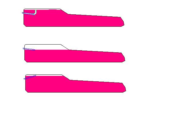

I had it modded but I took it off because of the drain problem. If the fuel blocks the vent line then the tank will only fill normaly.
The vent (and fill) tube is tilted down. At the rear the vent is about 2 inchs from the top, at the bafel its at least 3 1/2 inches. This will allow the vent tube to drain out.
If I put a sharp bend in it by adding a rubber tube it may not drain properly unless I put a float check valve in.
If I incline the the whole tube it will.
Anyway I'll make the mod that will work and post the pics.

I think you'd be better off pluging off the old tube and drilling yourself a new one at the top of the tank. The way your bottom illustration is set up the gas will literally drain out of the tank as opposed to causing backpressure and stopping the fuel from coming in anymore.
-OR- perhaps put aa A shaped bend at the very top of the vent...

If I'm reading this right... you are moding the air bleed that goes toward the top of the fill neck. If the air bleed is blocked then the air can only get out thru the main fill line. That can make it really hard to fill the tank at all with some pumps. As you've already found, you really want that line to drain.
Yes, you want to be carefull with the vent lines. Fuel can expand allot in hot weather. Way more than you might think. Especially when you fill a tank with fuel from a relativly cool underground tank in hot weather.
It's ok to do a tank alteration as long as the line can drain and it can't blow liquid up the evap vent. Dropping liquid fuel into the engine bay isn't a good thing. (POOF!:eek
