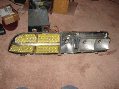

Report this Post12-08-2003 12:52 PM Click Here to See the Profile for MinnGreenGTClick Here to visit MinnGreenGT's HomePageSend a Private Message to MinnGreenGTDirect Link to This Post
Originally posted by Fie Ro:
You can take apart the GT lens, remove the inner lenses and put some vette lights (or others) IN there! that would be cool!
On the outside it would still have the stock housing. 2 variations:
Hehe... I've seen something like that before! Maybe as an ongoing project... in my garage
I'm pretty sure this is the first time I've posted this photo publically! I started working on this setup this past summer, but only got as far as to having the one side mocked up... maybe after the busy holiday season I can get back into the groove and try and get both sides done for next spring. note: I'm planning on using some form of LEDs (like the 18 wheelers sometimes have) instead of a standard-type bulb, and the 2nd light shown is photoshopped.

Report this Post12-09-2003 10:27 AM Click Here to See the Profile for MinnGreenGTClick Here to visit MinnGreenGT's HomePageSend a Private Message to MinnGreenGTDirect Link to This Post
I've seen the "strobes-r-us" site before... not bad, but I can get packs of 4 lights for around $70 from: http://www.buytruckstuff.com/s_product_gp.asp?selcategory=23
well if you want you can put them on my car...or did you mean on your car?
that photo looks really good, id love to have them
I'm not planning on selling "complete" units, but I may try and reproduce the insert panel so others can try something simliar if they like (it'll probably be a "blank" panel so the buyer can use whatever style fixtures they like & cut the holes themselves). I also might try something similar with a notchback taillight (as I have one or two sitting around) but that won't be at all until these are done.
Basically I used an original (damaged, not a good one ) lens as my form and to get a matching shape:
Then I removed the original "reflector" part of the assemblies using a roto-zip with a saber/side cutting tool:
I then trimmed the the part to fit the opening and did numerous test fittings & shapings to get it to fit:
Since then, I've added a flange to the inside edge to cover the raw cut left from removing the reflectors (this can faintly be noticed in the 1st photo I posted). I'm not yet sure about how or how many mounting points will have to be replaced on the fixture to assure that it's mounted securely... there is still quite a bit of work to go into these before they'll be done!

MinnGreenGT: I really like the way that you made that new rear panel. That would make it so much easier to mount aftermarket tail lights in there. I might be interested in two of those panels if you were willing to make them. Did you make them out of fiberglass? Or something else? Please keep us posted on the progress.
Report this Post12-17-2003 11:44 AM Click Here to See the Profile for MinnGreenGTClick Here to visit MinnGreenGT's HomePageSend a Private Message to MinnGreenGTDirect Link to This Post
Thanks - I'll definitely make an effort to at least reproduce the panels themselves... then probably just sell 'em as blanks so that any light can be used. They are made from fiberglass (currently 3 layers + filler for smoothing). If I get around to production ones, I'll try to have them be a smoother gel-coated part! You'd have to cut out the original reflectors, then glue the fiberglass panel in using a good quality expoxy/adhesive (I'll have a few recommendations after trying it myself).
