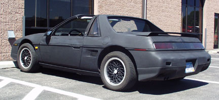

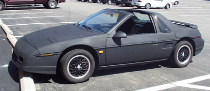

about time for an update. I've been away from this forum for a while. But I was busy this weekend. I had a change of plans on the body work. I'm moving soon and dont want to paint the car for the time being. I'll wait til I get settled in and have another car. So I just primered the car. The look is growing on my fast. Gives it more of a sleeper look Plus I can beat the piss out of the car and not worry about scratching the paint.
I didn't do anything to the deck yet, so I can't close it with the top intake attached.
you can see how tall this intake is.
With a little trimming, I can keep the hinge.

The primered look is always pretty cool - definitely a classic hot rod style, or now something I'd relate to an Exile Cycle You should shoot the wheels black while you're at it too!
if anyone would like the primered look, it would have to be you, rob.
btw, I knwo the front needs to be lowered, I'll be doing that when I install the big brakes. The rear tires are just sitting there. No suspension yet. I have to weld a few brackets on the cradle first. Its sitting on the jack. I could make it any height I want.
LOL - you bet!
Project GreenGT aside though, a few years back I bought an '88 T-Top coupe from Songman (while he was still in TN) that was all primer and had black GT wheels... even though it was rough all the way around - it got a lot of positive attention wherever I took it!

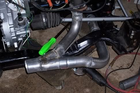

This is how I am running the exhaust. This is 2.5" mandrel bends. Into a 3" collector. Using 2.5" mandrel bends takes quite a bit of real estate. This is where I ended on this pic. Once in the car, I'll fit the 3" mandel 180* turn into my muffler, then duel 2.5" out to the tips. I lost my trunk anyways, so I used the space. I will run duel outlets closer to the center when I paint the car. Sort of like a BMW M3(I think thats the model) Not centered, but not wide. I have to lose the trunk for this.
This images is larger than 100K. Click to view.
The suspension is all back together(as seen in the pics above) I have to weld in the O2 sensor bung. Install the struts and brakes and I'll be ready to fire her up. Up front I'll be installing lowering springs and the big brakes as well. I was hoping to finish for the Auburn show, but I wont make it. I'll be out of town all day saturday instead of heading to the show. And my MEMCAL is still en route.
after the car is running and I feel comfortable with the way it feels, I'll be installing the LS1 coils and reversing the intake. I have the cam sensor I want to use. I'll need to install it in the existing distributer. Its looks fairly simple to install, but It has to be in the right place. being that this is a used motor, I feel more comfortable getting things running first before I start tinkering with it. Goal is to have the LS1 coils running and intake done for FieroRama.
btw, the leather seats are great to sit on while doing the interior wiring, I hope they're just as nice while driving.

Be sure to put some heat shields around that exhaust system. It looks perilously close tothe CV boot of the axle and to the AC compressor for comfort. Otherwise, looking good.
