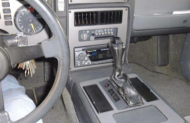

I've got an in-dash OEM Pontiac CD player from a '96 Sunfire(?)... it looks completely stock in my Formula.
