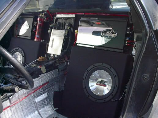

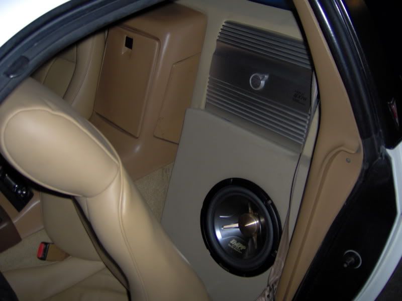

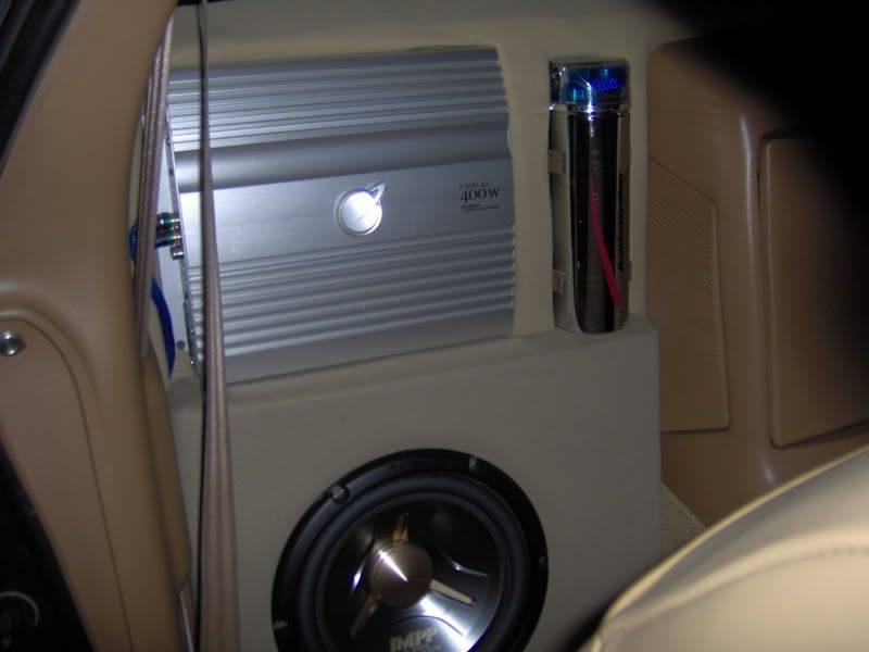

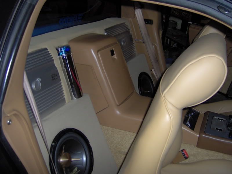

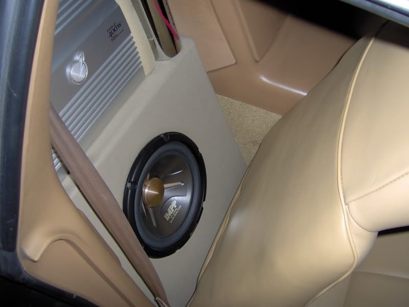

2- 10" behind the seats with 0.6cf of air space in ea.... only lost 2 3/8" of tilt & the seat still goes to back to stock posion. 6 1/2' comps in the dash & 4X6 plates in the pillers. 800W RMS total. Everything is inside!
Just where would you "port" the tubes through? How big would they have to be? Have you seen a fiero with the dash & HAVC all out? Not much room to port tubes through.....
Nice system Chris... and a very clean install. I like it!

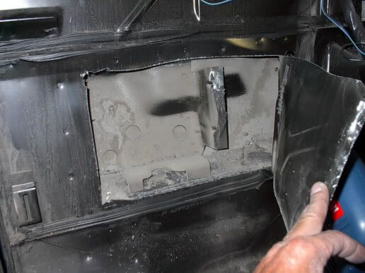

So no cutting of the firewall? ive been trying to find a place for my external 300 watt amp and 6.5" sub ( yes its small, its so i might be able to get it to fit up in the dash ) .. ( already replaced the dash and pillar speakers with poly 3way's, and a receiver that puts out 250 total ).
But what you did might be a better idea, if i dont have to cut anything. I was worried about blowing out too much cabin space on the passenger side if i didnt cut holes like most people do, which i wont do.. It isnt often, but once in a while i do have a rider so its a consideration.
06:04 PM
Wheels1 Member
Posts: 945 From: Hutchinson, Ks. USA Registered: May 2002
Sorry, I never said I didn't cut anything. Yes I did cut the cover plate, NOT the firewall. It's really just a cover plate, after you remove it you can see out in the corner to the filler hose. Here are some pics of the cover plate cut. The firewall is behind that. It's just enough space for the magnet of the sub to fit in.
Darn... Really trying to avoid cutting anything.. :|
08:09 PM
Wheels1 Member
Why? It don't do anything to the car, I did my system over 3 years ago with no problums & it's not that hard... I have a cd with over 300 pics of all my install stuff to help you through it.
