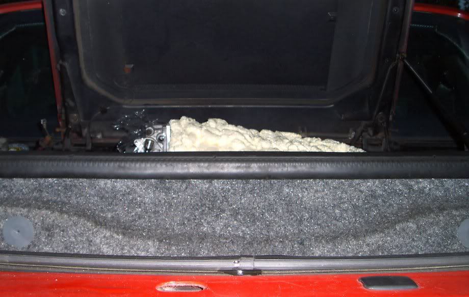

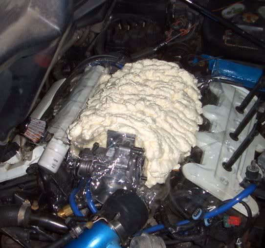

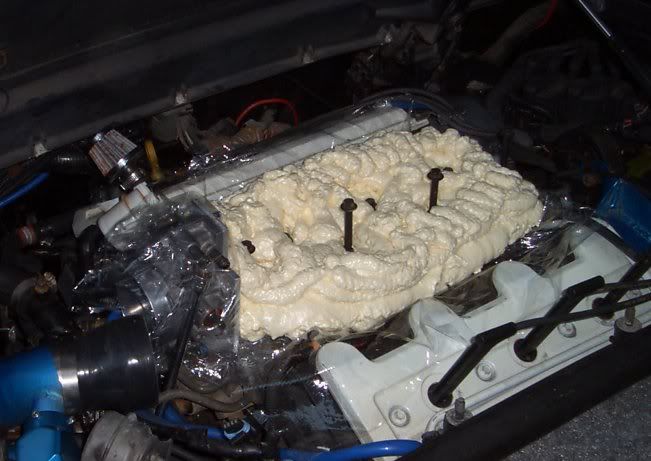

construction has progressed to phase 2 (plug creation) of my custom short runner intake - this should also negate the 96-96 intake upgrade
TB coolant line is bypassed by threading a 90* brass fitting in and then sealing it with a high temp epoxy putty (yes it is sealed its been running with it like that)
http://img.photobucket.com/albums/v435/kohburn/coolant-bypass.jpg
then we have construction of the new plenum baseplate and TB mounting plate for the 96 dohc TB
http://img.photobucket.com/albums/v435/kohburn/Cam_0688.jpg
http://img.photobucket.com/albums/v435/kohburn/Cam_0690.jpg
now today we have the foam plug foaming
http://img.photobucket.com/albums/v435/kohburn/Cam_0692.jpg
http://img.photobucket.com/albums/v435/kohburn/Cam_0693.jpg
http://img.photobucket.com/albums/v435/kohburn/Cam_0694.jpg
http://img.photobucket.com/albums/v435/kohburn/Cam_0695.jpg

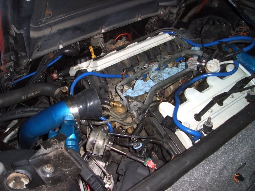

fabbed up my vacuum distribution block, my breather and PCV lines along with painting the core of my oil catch can that goes on the PCV line (catch can is filled with copper dish scrubbers to help knock any oil droplets out of the air, tip i picked up on GRM)
catch can will be mounted on the trunk wall directly behind the TB so that its ports will be facing the TB ports.. the lines are all layed out about how they will be on the engine with the intake plenum in the center.
http://img.photobucket.com/albums/v435/kohburn/Cam_0753.jpg
and from the rear window
http://img.photobucket.com/albums/v435/kohburn/Cam_0755.jpg

mounted everyting to the engine - ran the vac lines - and fired it up real quick - it roared to life and then i shut it down untill i can update the charge pipe to fit up to the new location of the TB
http://img.photobucket.com/albums/v435/kohburn/Cam_0757.jpg

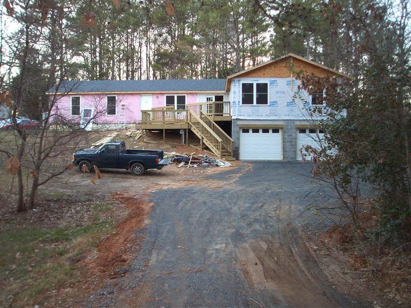

not really - been busy building my new "garage"
BobadooFunk
Posts: 5436
From: Pittsburgh PA
Total ratings: 128
Report this Post01-17-2007 04:33 PM Click Here to See the Profile for BobadooFunkClick Here to visit BobadooFunk's HomePageSend a Private Message to BobadooFunkDirect Link to This Post
wow... beautiful!
