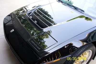

Report this Post11-04-2008 07:07 AM Click Here to See the Profile for hyperv6Send a Private Message to hyperv6Direct Link to This Post
If the trunk seal is in tact there is no seal for the radiator or headlights. A little more water comes in from the top into the radio but that is about all. It is a non issue.

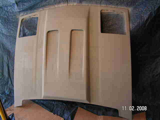

here is a pic of mine in progress

Owned by Winkie, this looks like a finished version of the one immediately above:
Originally posted by Winkie:
Both hood vents appear to originate from PFF member, Tha Driver, and look great IMHO.

Originally posted by hyperv6:
Hey Hyperv6, I don't remember seeing this car B4. Do you have a thread with more (larger) pics of it? I like it.
Thanks.

I sold this car earlier this year and miss it. The hood was cut, layered with the old pieces of fiberglass to fill the deep gaps using 3M's 8115 then I used expantion foam to filled the hollow area incase dirt worked its way on the inside of scoop. Lastly I glued it down with 8115 and sent it out for body work & paint to finish it Rick B

here's ours, slowly making its way to paint:-)
