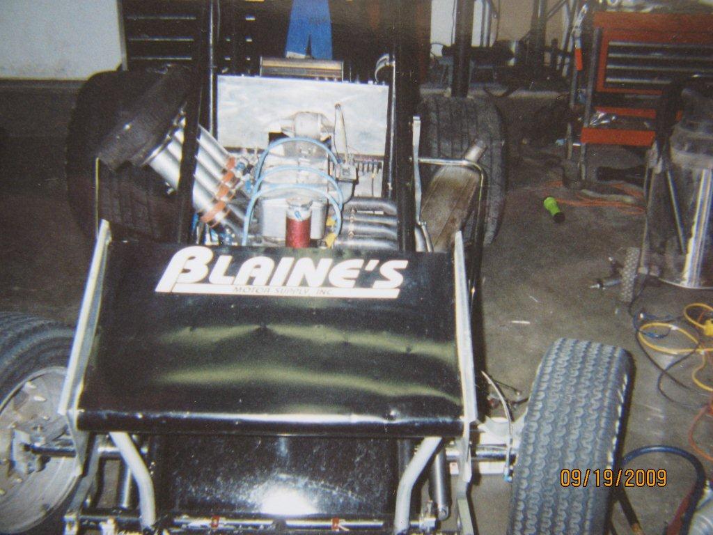

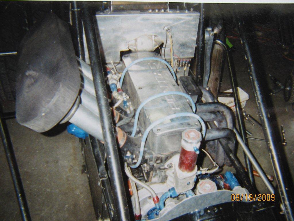

I am running the single oval K&N Super Duty air filter on the intake, but want to switch to the 4 small individual air filters, one per port, which I think are K&N but I have no idea what the part number is for them.
I am trying to make more room under the hood and these will really make clearance much easier if I can find them.
If anyone can tell me what the part number is or point me towards someone who might know, I would appreciate it. I know I have seen pictures of them on another SD4 Fiero, just can't find a part number
Here is a couple pics of Stickman's to show what I am talking about

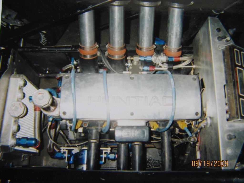

Here is the one I ran on my Kinsler Injection setup. It is a KN special order from what I remember for the KEFI spacing.
I have tried to find the part number, but KN and Kinsler do not seem to list it. It was special made for the SD head setup, but the 702 head was the same port spacing.
*edit* ok, I found the old Kinsler part number 5119 . I looked on KN racing site however and did not find it there. Kinsler had about 8 of these in stock back in 1996.

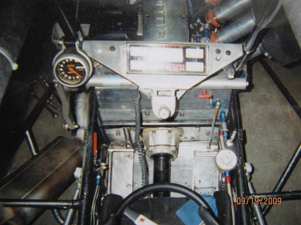

Here is the only other 2 pics I have the KFI setup. this is when it was a mechanical system. I later changed it over to EFI running the Haltech F7 box on it. Be sure to get the dial a jet you see in the photo of the cockpit area. Those are nice. The direct drive fuel pump was from KFI also.
