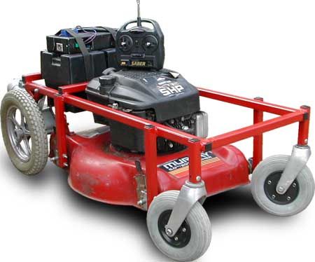

Anyone ever do this? I have a box full of old remote control cars so the control part is taken care of.
I was thinking why couldn't they be adapted to a couple of old starter motors to push my lawn mower around. The front wheels would have to be replaced with casters. The rear wheels would be a direct drive, they already have the notches in the wheels and are large. If you put a motor on each wheel you could steer it.
Sounds simple. SO would it be too hard to control with a simple on off type control for the motors? Would the starter motors run in reverse? Should I uses some other motor that I can control the speed better?
So Jake why are you so lazy that you cant push your lawn mower around. Well guys I have a hard time breathing after mowing just half the yard. The dust and grass dust is so bad here in Florida that I cant stand to mow, if I could sit in the driveway and steer the mower around or even stand a few feet away from it I could avoid most of the dust.
Why not just pay someone to mow the grass? Ha let me ask you this, who works on your Fiero? If your like me you don't want anyone else touching your stuff.
This could be fun, I have only thought of this for about an hour and I already have the front wheels figured out and will be able to install them right away, even if I don't put the remote part on the mower it will make what I have now turn better as it will have turning front wheels instead of fixed wheels.

Yes those were my inspiration but I was going to try and make it more compact. I will have to keep my eye out for a used (Free) lawn mower. They are always getting thrown away around here when they quit working. Most of the time its just a spark plug or air cleaner issue.
My current mower already has the large back wheels, I think those will give me the best gearing for a direct drive mounted on the tires. I just need to figure out what to use for the motors. I wonder if Fiero head light motors would work? I don't think they turn fast enough to push the mower around the yard.
My current mower has a dead mans switch, I could use it with a switch on the electric motors in case it runs off on me. Just install a trip wire around the yard to kill the motors if it hits it. That will also keep the kids out of the yard at night LOL

Thats what the other guys are doing. They just replace the rear wheels with the power chair drive and rig up a remote interface.
I want to make something that I can pull the handle and attach to the existing mower.
http://www.freepatentsonline.com/6899345.html
Something like this only I want to reuse the existing wheel and adjustment levers.

This is how I want the rear steering to work. This will also allow me to turn the mower and line it up with the cut I just made.
It seems to me that the ones on line are going way to fast, one of them was popping wheelies. They would be hard to catch if something went wrong and they would be hard to control. I want something that has a lot of TQ but speed isn't what I am after. It needs to go about the same speed as me walking behind it. I think a tethered kill switch would be good, its much harder for a simple mechanical switch to fail then to depend on electronics to stop it from mowing the neighbors flowers or worse.
For controls I was thinking of something as simple as the automotive electric windows, just use relays instead of switches. Because its not moving fast a simple on off switch shouldn't be that hard to control. Plus I have a parts car with working switches and motors.

Ok I guess this will get done. I have some great ideas just need to see what happens first. There is a power chair place on the way home from work, I will stop in and see what they do with old chairs. I will also keep my eyes open for a free lawn mower to get a deck to work with so I don't have to use my existing lawn mower.
The hover mower is a good idea, it would keep the total weight down but it would also not be as effective as a heavy steel blade as Florida grass is pretty thick and hard to cut.

For steering I think having both drive wheels turn independent of each other. The front wheels will be free to pivot like most self propelled mowers are now. To turn I just shut power off to the side I want to turn into and the other side will power the wheel around. This will pivot the mower on the wheel and line it up for the next path I want to cut. This is how most wheel chairs work and may save me some time finding a drive train if I can find a used wheel chair. I already found one on line if they still have it. If not then I have other ideas. I already have some tubing to make the frame out of.
Think of the Zero Turn Mowers.

Basic lawn mower with a independent drive system. The blades will run off the gas engine and the drive will be electric.
