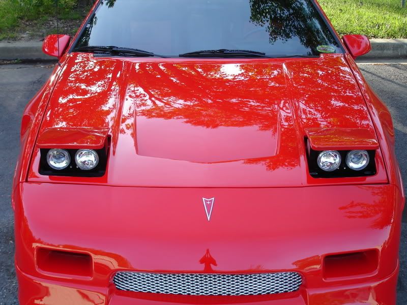

Looks good! PM sent. Goes from a cutsie look to a somewhat aggressive look. ------------------ '85GT Indy clone 4.9 4T60E '78 Toyota longbed, parts runner '89 Bonneville daily driver '87 30' Kit Classic TT, living in it.

I agree but I am still looking for an even lower profile light I can use. If anyone can find a light that is lower and wider with twin beam H4 bulbs and its own mounting bracket that can be attached to my buckets I will give them the first set of buckets free!!!

i installed my headlites today but i am having fitment issues. I am at work so i don't have time to look through all the other posts so i don't know if anyone else has had the same issue. When looking atthe rear of the light with it assembled, the upper left and right adjusters are scraping the head light doors. Hard enough its scrapped the paint off. Can i run these in far enough that it won't hit anymore but still have a good lite pattern? Reason being its going to be a pain in the ASS to take the adjusters apart and move them to the lower courner.
Is it possible your lights are aimed too low and causing the rear of the adjusters to point upwards? I haven't gotten mine in the car yet, but aiming the headlights up more would cause the adjusters to tilt downwards.

I know I don't have that problem, But I'll check out clearences and see if it's close. Are you sure it's the adjuster and not the side edge of the buckets? I also used the edge molding on the sides as well as the top front edge. Maybe putting the edge molding on the side may offer a little bit of clearence.
nevermine....i got em to fit. i was s bit hasty in poting the first post. after getting back to the car irelized that turning will only move the lite ot the adjuster . i got em to fit my moving both of the headlite assembly inwards. they still rubbed alil so i jus pushed over on the new buckets till they bent slightly. problem solved.

Has anyone found that on the lowbeam light, the upper screw and loop on the light housing is higher than the bucket and consquently the head light lid rests on the light housing and not on the bucket. This seems to put all the tension from the headlight lid on the the lowbeam housing.
I asked this same question ... but without pictures ... back on February 3 (p. 6 of this thread) and again on February 17 (p. 10):
Originally posted by Marvin McInnis:
... it looks like there could be a small clearance issue at the top of the low beam modules when they are mounted outboard, as required by U.S. regulations.
Timo's answer at that time was, "They fit just fine."
He originally designed the buckets to mount the low beam modules inboard, where clearance is less of an issue, and I think that is probably the source of the problem.
